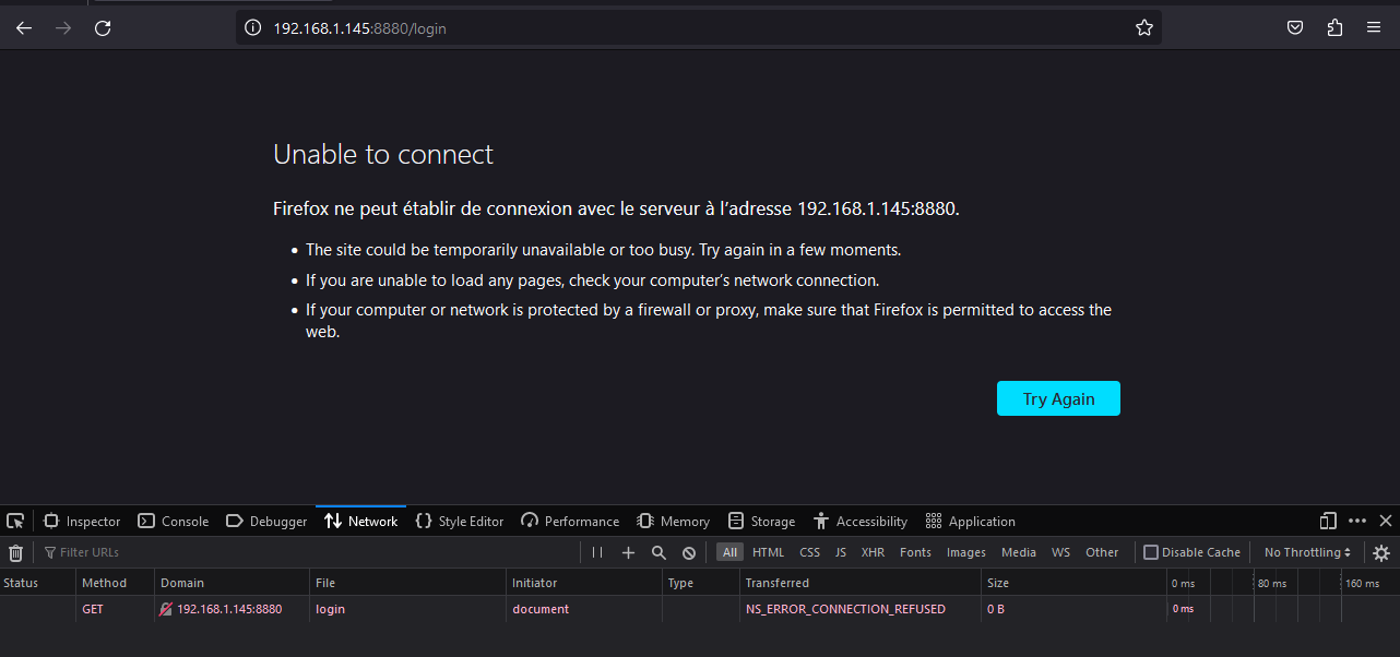

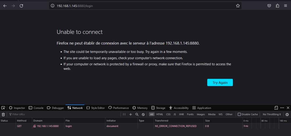

Hello @ljm42
I tried both, but each time I get a error trying to reach the webgui.
ERR_CONNECTION_REFUSED
I also made sure to empty the cache before trying.
