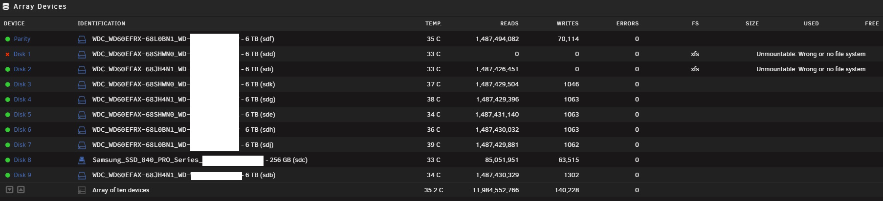

Now on the Main screen I see for both Disk 1 (the failed disk) and Disk 2 (the newly replaced):
Unmountable: Wrong or no file system

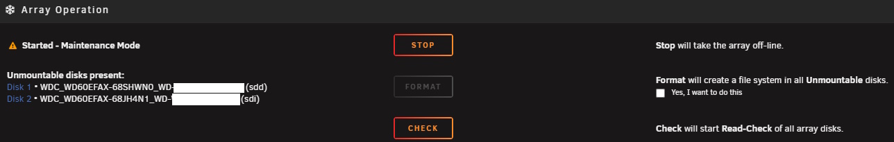

Also those two disks are available for formatting in the Main screen / Array Operations:
Unmountable disks present:
Disk 1 • WDC_WD60EFAX-68SHWN0_... (sdd)
Disk 2 • WDC_WD60EFAX-68JH4N1_... (sdi)

The array is in maintenance mode. I have attached the status of the Main page.

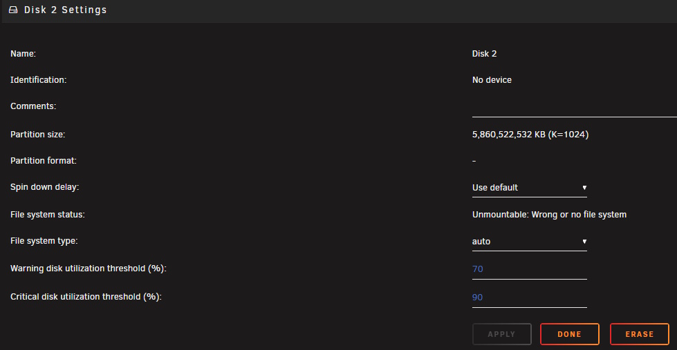

I stopped - started the Array in Maintenance mode.
File system type for Disk 2 is "auto" and there is no Check button. The other disks have all options available.
tower-diagnostics-20230916-1429.zip
You need to change the filesystem to xfs first
