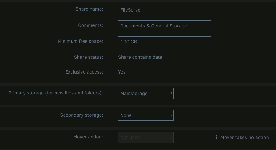

Unraid is just as fast as TrueNAS if you're accessing a share that has "Exclusive access" enabled - it must not be set up to use mover and can't be part of a regular array. So using Unraid 7, where you don't need an array, you can use a nice ZFS Pool and there are no such issues with MacOS and SMB. Wicked fast always.
No (other) special configuration on Unraid or MacOS - except to turn on Exclusive Access in the Unraid Disk settings and the restrictions I mentioned above.
Edited by Espressomatic
Is Exclusive Access a Unraid 7 feature?
Never mind I answer my own question.
I tried this also and maybe got 3 backups to work and then it would stop.
Edited by ijuarez
Your share should look like this, right?
Exclusive yes, no secondary storage, no mover.

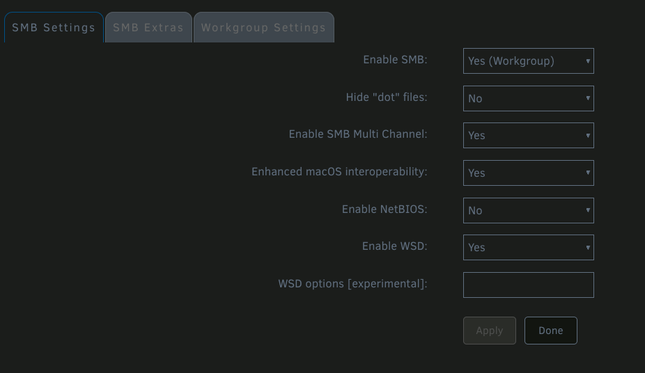

Then this is my SMB settings page:
That's my setup on three systems. On a fourth system, it turns out I still have some left-over SMB Extra parameters specified from before I updated to Unraid 7 and switched to using ZFS Pools. However, all 4 systems seem to work as reliably as each other.
#vfs_fruit compatibility for Apple SMB
[global]
vfs objects = catia fruit streams_xattr
fruit:nfs_aces = no
fruit:zero_file_id = yes
fruit:encoding = native
spotlight backend = tracker
fruit:metadata = stream
fruit:posix_rename = yes
readdir_attr:aapl_max_access = no
readdir_attr:aapl_finder_info = no
readdir_attr:aapl_rsize = no
