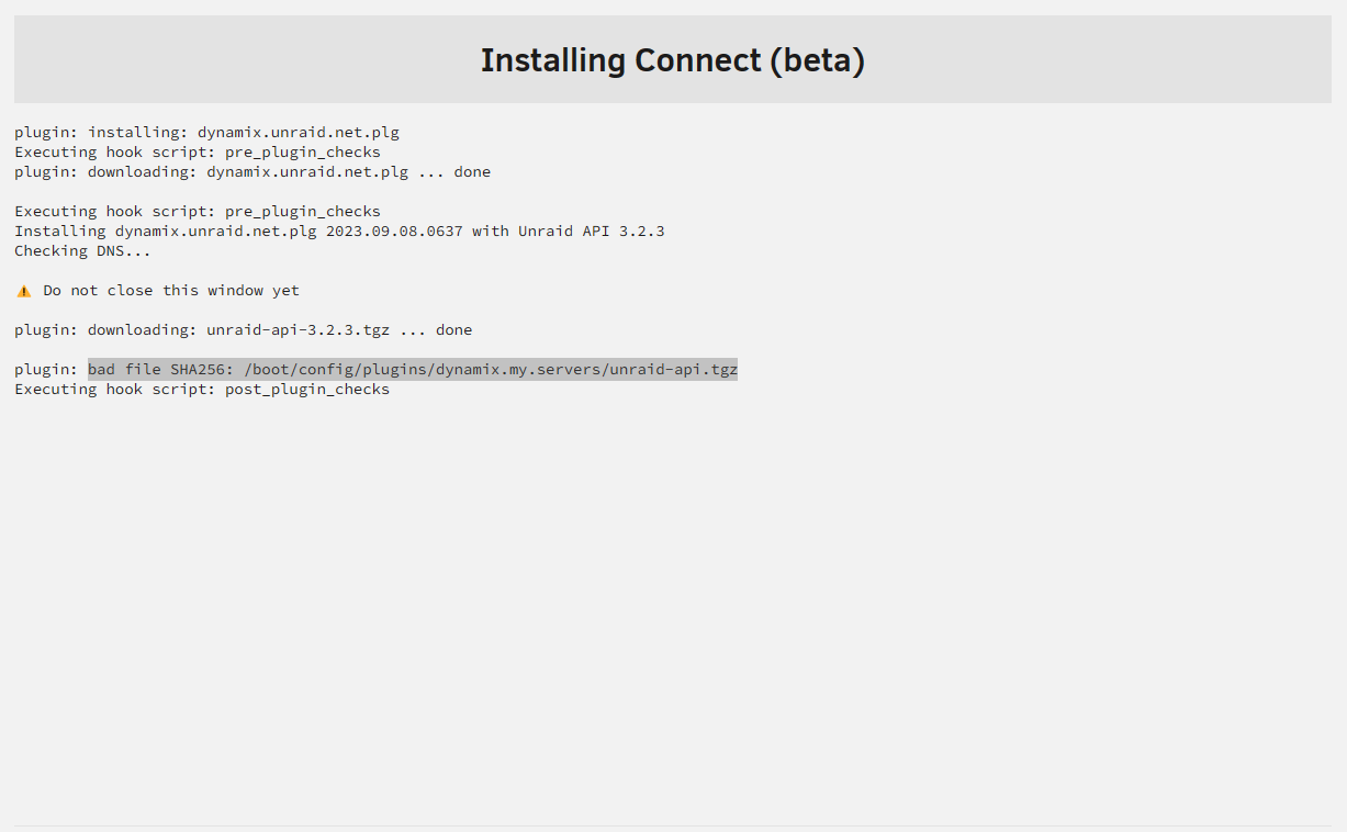

Okay, So this is what pops up in the plugin install window (emphasis mine):
plugin: installing: dynamix.unraid.net.plg Executing hook script: pre_plugin_checks plugin: downloading: dynamix.unraid.net.plg ... done Executing hook script: pre_plugin_checks Installing dynamix.unraid.net.plg 2023.09.08.0637 with Unraid API 3.2.3 Checking DNS... ⚠️ Do not close this window yet plugin: downloading: unraid-api-3.2.3.tgz ... done plugin: bad file SHA256: /boot/config/plugins/dynamix.my.servers/unraid-api.tgz Executing hook script: post_plugin_checks

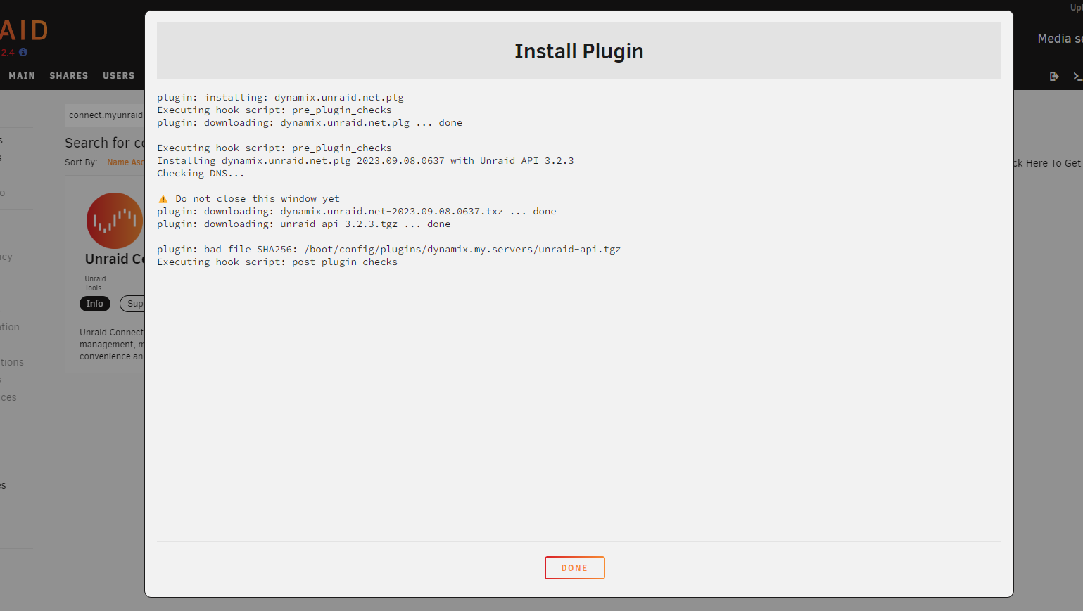

Same result:
plugin: installing: dynamix.unraid.net.plg Executing hook script: pre_plugin_checks plugin: downloading: dynamix.unraid.net.plg ... done Executing hook script: pre_plugin_checks Installing dynamix.unraid.net.plg 2023.09.08.0637 with Unraid API 3.2.3 Checking DNS... ⚠️ Do not close this window yet plugin: downloading: dynamix.unraid.net-2023.09.08.0637.txz ... done plugin: downloading: unraid-api-3.2.3.tgz ... done plugin: bad file SHA256: /boot/config/plugins/dynamix.my.servers/unraid-api.tgz Executing hook script: post_plugin_checks

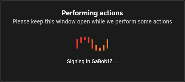

Previously I had connect installed, but couldn't login.
Stuck at
