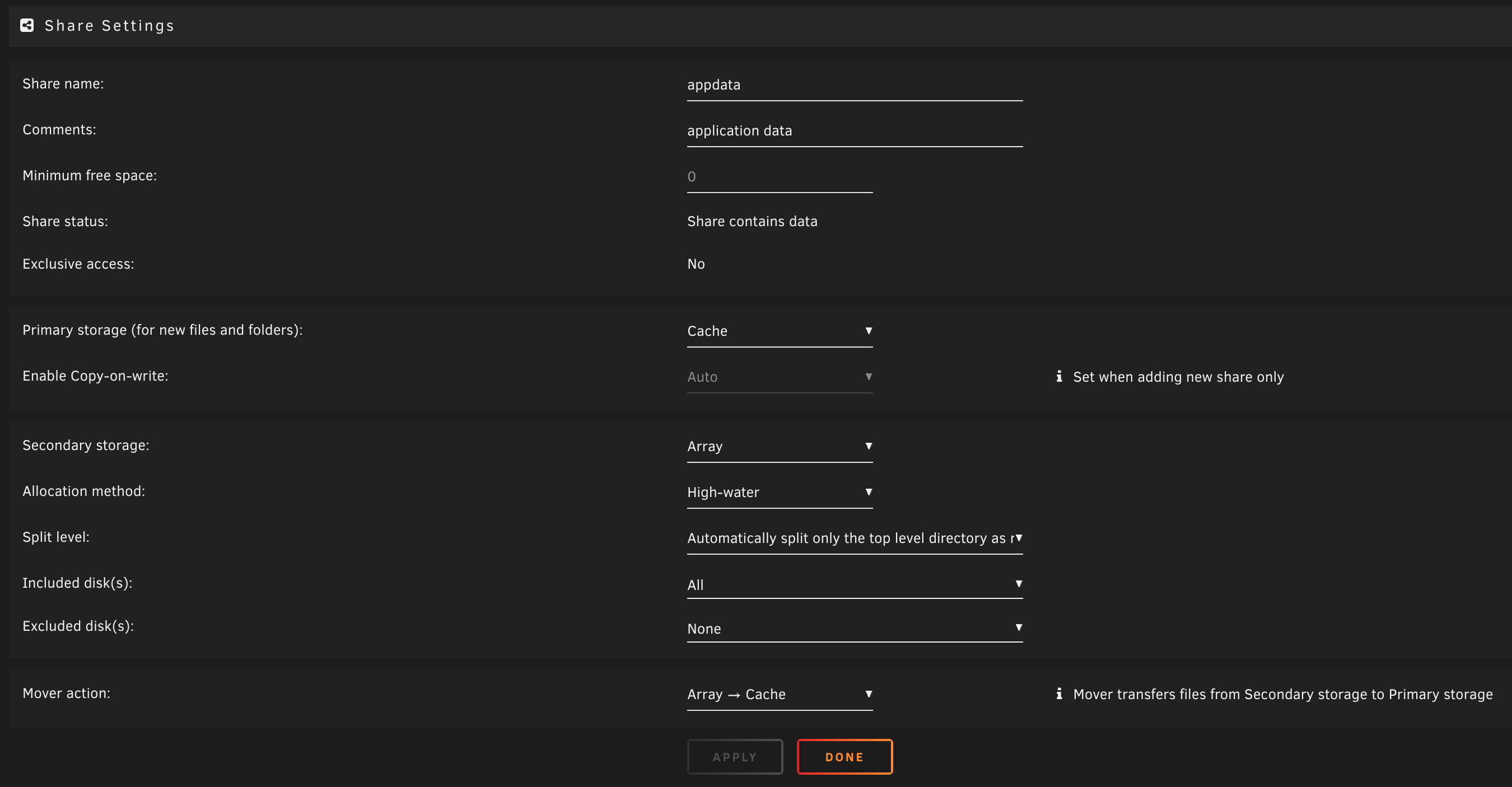

Hmm, you are correct (obviously). I see some Jellyfin data is on disk2, but it's the only appdata that is on disk2. Weird, since the appdata share is configured to move from the array to pool. Could this simply be because I have the array configured as secondary storage? I'm assuming these settings are in the diagnostics somewhere as well, but if not:

Probably that container had to write some appdata and cache wasn't available for writing.
Mover ignores shares that have nothing set as Secondary.
Nothing can move open files, so you have to stop that docker before its appdata can be moved. I usually just say Disable Docker and VM Manager in Settings.
Mover won't replace files so if a file exists in both places, you will have to decide which to keep.
