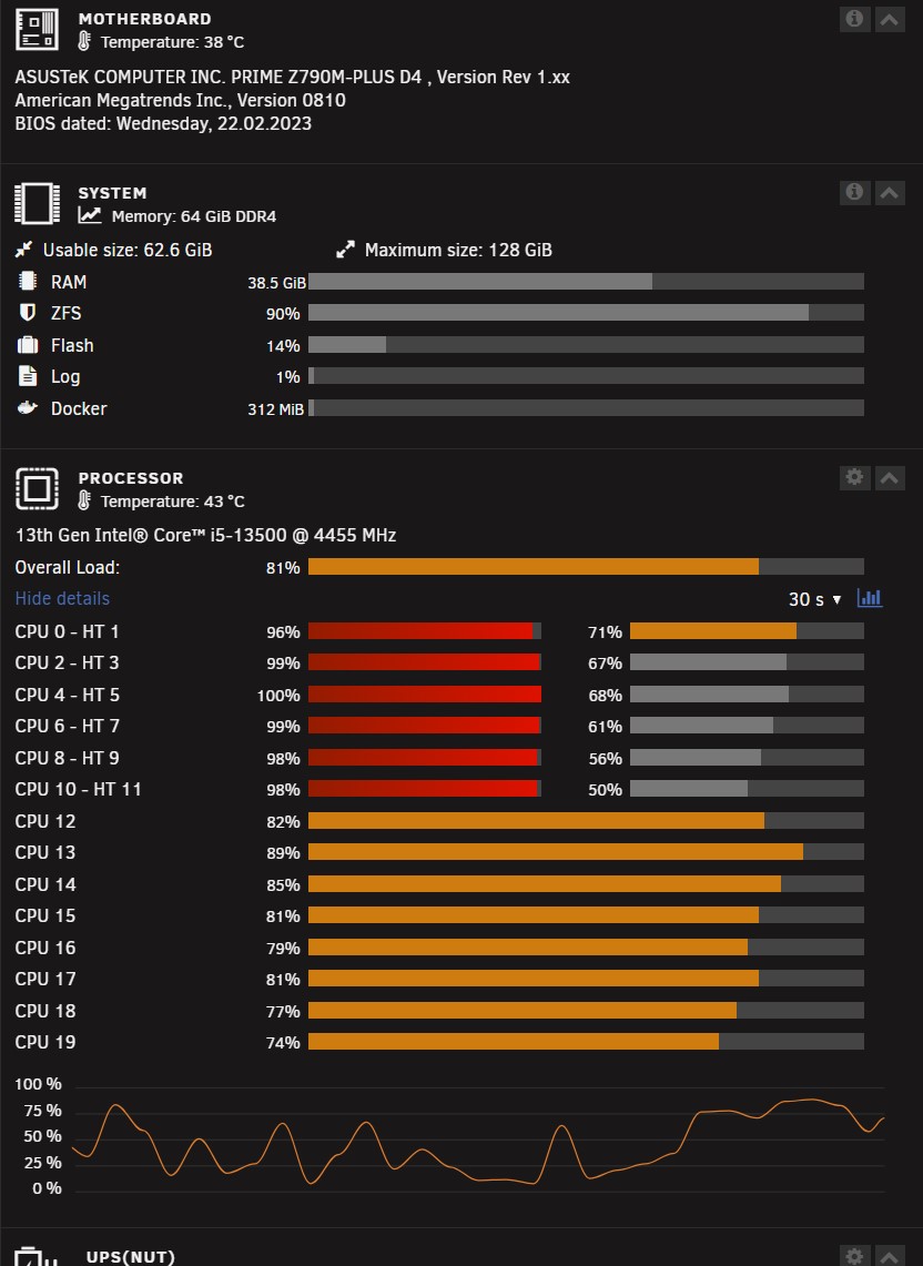

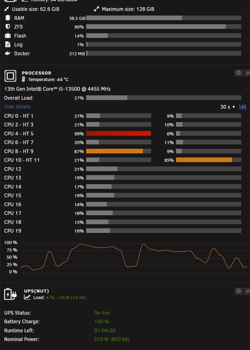

Unraid starts to be laggy as hell after a while and dies
I have no idea what is happening. Since a few days it's the second or third time that it happened. Nothing special was done. Earlier I thought it was because people were watching Plex on my server and killed my bandwidth and more (even though it makes no sense to get the problem that I have).
It randomly appears and starts by some Docker containers getting unhealthy and restarting. And then the loop starts. If I want to go to the unRAID web UI it's loading 1 minute if I'm lucky. I was able to make a screenshot but I guess the high load occurs because all containers get unhealthy and the autoheal tool restarts them all and they never get healthy again.
The only suspicous thing I also realized is that my Nextcloud Docker instance also starts to fail several times a day since a few days. The 200 status code turns into 503 and Nextcloud enables automatically the maintenance mode and I always have to set it to off again and everything is just fine.
I was lucky to get the diagnostics before it was completly unusable and unresponsive. The only thing that helps is a restart. A parity check was finished today without errors. I have changed nothing on my hardware setup. Also the unRAID version 6.12.6 is installed since a while now. Temperatures are also okay with temps around 40 degree. I'm running nearly 100 Docker containers but that's all. No VM was running or anything else.
I had a look into the diagnostics docker.log and you can also see what I described in the last 3 days because the logs are there:
time="2024-01-31T01:02:31.586877851+01:00" level=info msg="loading plugin \"io.containerd.event.v1.publisher\"..." runtime=io.containerd.runc.v2 type=io.containerd.event.v1
time="2024-01-31T01:02:31.586918839+01:00" level=info msg="loading plugin \"io.containerd.internal.v1.shutdown\"..." runtime=io.containerd.runc.v2 type=io.containerd.internal.v1
time="2024-01-31T01:02:31.586926061+01:00" level=info msg="loading plugin \"io.containerd.ttrpc.v1.task\"..." runtime=io.containerd.runc.v2 type=io.containerd.ttrpc.v1
This repeats very often. I don't know what is causing this error. Is it some kind of memory leak? But look at the screenshot there still is enough RAM... please help me!
unraid-server-diagnostics-20240201-0155.zip

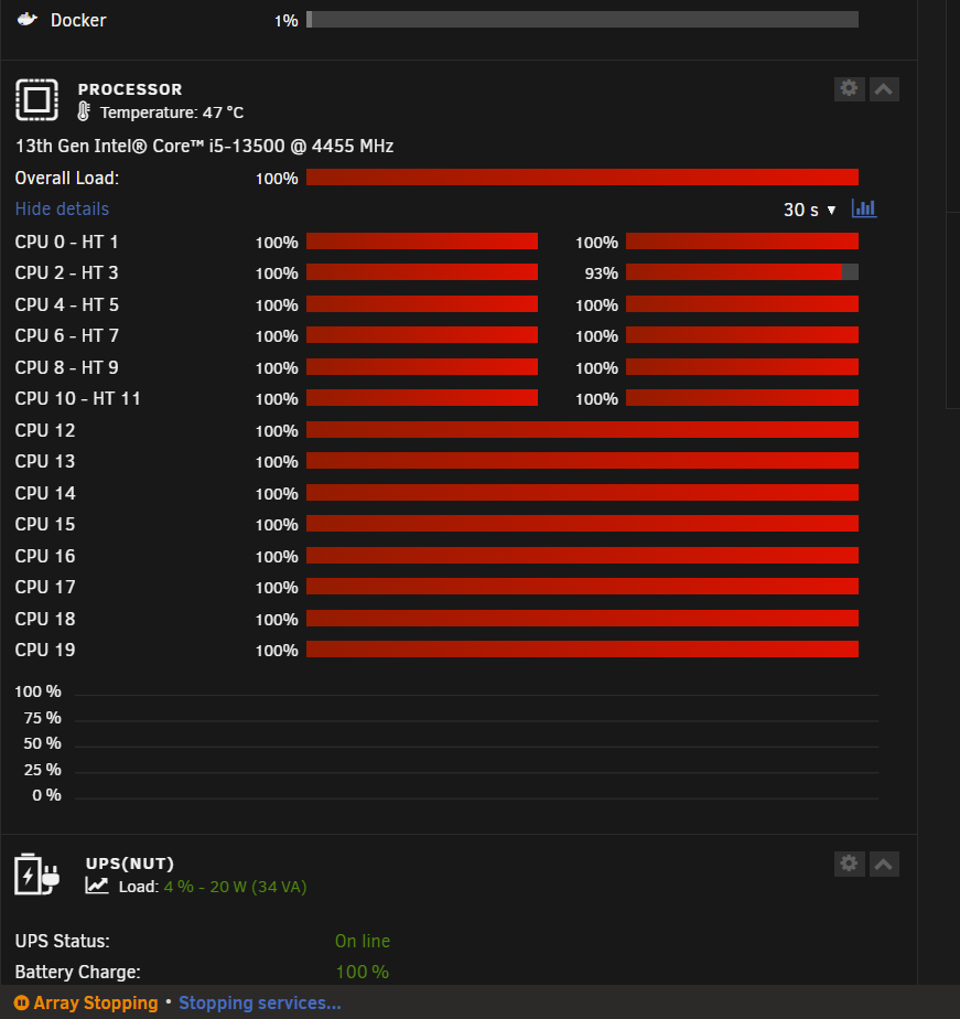

It's not even possible to restart. After clicking restart and waiting 10 minutes I can get back on the Dashboard after a while to see this:
Edit: Another thing I realized now is that my Nextcloud for example runs so much faster after that reboot but will get slower from time to time. Must not have anything to do with Unraid but I realized it.
Edited by sasbro97

Is that after reboot?
Yes. No chance to keep it running while it is in self destruction mode at 100% CPU load.
Setup syslog server.
And get diagnostics before it begins to get too bad.
What I was looking for from that command was just the first result, so you can try it yourself periodically to see how it is going
df -h /
That will just give the first result, which is rootfs. That is where the OS files are (in RAM). If you fill it up things can go bad quickly since the OS has no space to work in.
Does the syslog server just record the system log? Because I had a look on the logs before it crashed and everything was fine. Sometimes before there was this typical NGINX bug that was filling up the log like hell.
I'm wondering that my system told me now unclean shutdown detected and started a parity check again because I just rebooted after the syslog server setup to start with all logs after a boot and be sure. I know that the shutdown was unclean the time before when the server died but not now after I just clicked rebooting. I canceled the parity check yesterday. Is it because of that?
And I realized that I did one change but it was also days ago. Is it maybe the reason? I created a user script that is resizing the log partition because I'm tired of restarting when the NGINX error occurs out of nowhere:
#!/bin/bash
#description=This script sets the log partition to 4GB.
#name=Resize unRAID log partition
mount -o remount,size=4048m /var/log
Yes.   The point is to get the log right up to the point immediately before the crash.
You can get an unclean shutdown even when simply clicking the Reboot button on the main tab if Unraid was unable to stop the array successfully.   It should be irrelevant what happened earlier.    Have you confirmed that you can stop the array successfully before hitting Reboot within the timeouts set as described here in the online documentation accessible via the Manual link at the bottom of the Unraid GUI.  In addition every forum page has a DOCS link at the top and a Documentation link at the bottom.   The Unraid OS->Manual section covers most aspects of the current Unraid release.
Filesystem      Size  Used Avail Use% Mounted on
rootfs           32G  540M   31G   2% /
It happened again and its not rootfs.
It started at 16:05 when my Nextcloud was going down again. Always the first thing that happens. I can see obviously in the logs that this messages are repeating endlessly but I don't know what they mean and what is causing them:
Feb  1 16:02:56 UNRAID-Server kernel: br-71456806b542: port 42(vethb0c30bd) entered disabled state
Feb  1 16:02:56 UNRAID-Server kernel: veth6b2d3ed: renamed from eth0
Feb  1 16:02:56 UNRAID-Server kernel: device vethb0c30bd left promiscuous mode
Feb  1 16:02:56 UNRAID-Server kernel: br-71456806b542: port 42(vethb02ff3a) entered blocking state
Feb  1 16:02:56 UNRAID-Server kernel: br-71456806b542: port 42(vethb02ff3a) entered disabled state
Feb  1 16:02:56 UNRAID-Server kernel: device vethb02ff3a entered promiscuous mode
Feb  1 16:02:56 UNRAID-Server kernel: br-71456806b542: port 42(vethb02ff3a) entered forwarding state
Feb  1 16:02:57 UNRAID-Server kernel: eth0: renamed from vethc7012bb
Feb  1 16:02:57 UNRAID-Server kernel: IPv6: ADDRCONF(NETDEV_CHANGE): vethb02ff3a: link becomes ready
Feb  1 16:06:07 UNRAID-Server kernel: br-71456806b542: port 42(vethb02ff3a) entered disabled state
Feb  1 16:06:07 UNRAID-Server kernel: vethc7012bb: renamed from eth0
Feb  1 16:06:07 UNRAID-Server kernel: device vethb02ff3a left promiscuous mode
Feb  1 16:06:07 UNRAID-Server kernel: br-71456806b542: port 42(veth08927d3) entered blocking state
Feb  1 16:06:07 UNRAID-Server kernel: br-71456806b542: port 42(veth08927d3) entered disabled state
Feb  1 16:06:07 UNRAID-Server kernel: device veth08927d3 entered promiscuous mode
Feb  1 16:06:07 UNRAID-Server kernel: br-71456806b542: port 42(veth08927d3) entered forwarding state
Feb  1 16:06:08 UNRAID-Server kernel: eth0: renamed from vethd074a55
Then 50 minutes later I can see a big error. I just let the system do and running on 100% CPU:

Then the first logs started repeating again.
I tried to stop Docker because I thought it is the reason but the system was still completely unresponsive and 100% CPU load and lead to red CPU error messages and also something like this:
Feb 1 17:55:20 UNRAID-Server kernel: out_of_memory+0x3b3/0x3e5
It only stopped as I stopped the array. Now everything is normal. No logs are created.
