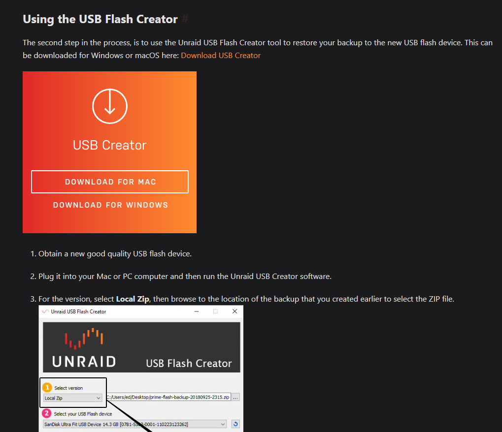

I also have a backup on Unraid connect that I can restore, Do I just copy those files to the usb or do I need to use the USB creator software to write the zip file to the new usb drive?
