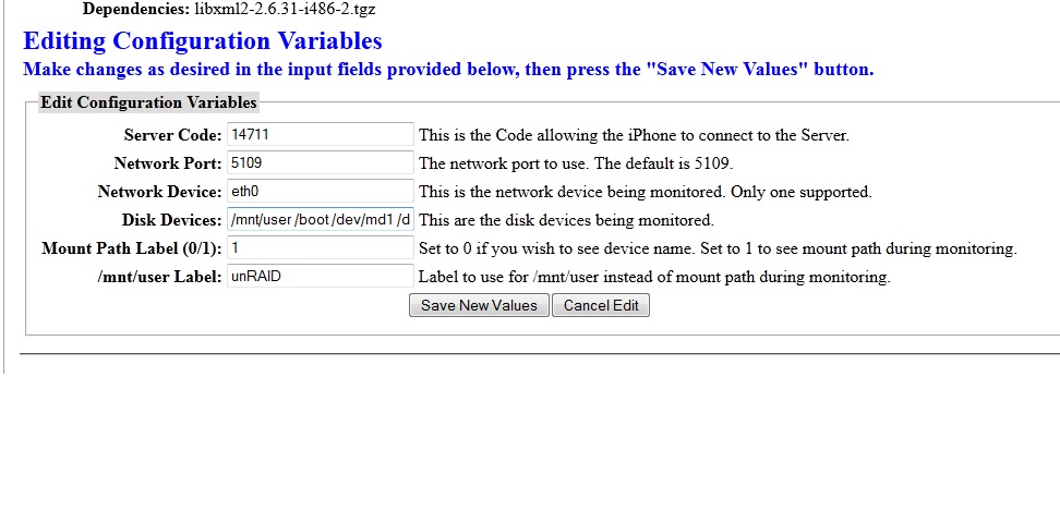

I have installed iStat. Right now its onlt monitoring the boot device. What syntax do i need to put in Disk Devices to see my hard drives in the array?

OK,
I have this working and not 100% sure what it was or the fix. I wrapped the Disk Devices in " " and got some of it but not the total raid size.

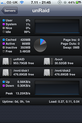

I have rebooted once or twice and now i have it displaying
"/mnt/user /boot /dev/md1 /dev/md2 /dev/md3 /dev/md4 /dev/md5 /dev/md6 /dev/md7 /dev/md8 /dev/md9 /dev/md10 /dev/md11 /dev/md12 /dev/md13 /dev/md14 /dev/md15 /dev/md16 /dev/md17 /dev/md18 /dev/md19 /dev/md20"
