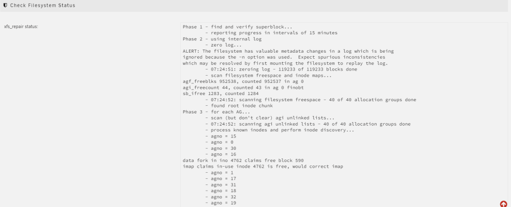

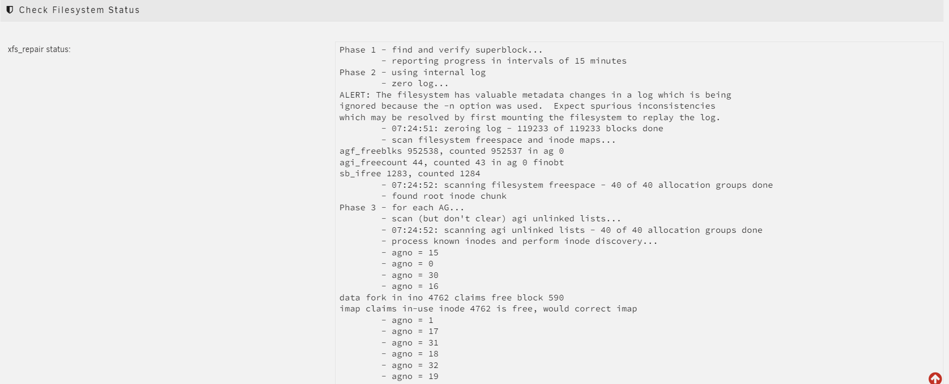

Phase 1 - find and verify superblock...
        - reporting progress in intervals of 15 minutes
Phase 2 - using internal log
        - zero log...
ALERT: The filesystem has valuable metadata changes in a log which is being
ignored because the -n option was used.  Expect spurious inconsistencies
which may be resolved by first mounting the filesystem to replay the log.
        - 07:24:51: zeroing log - 119233 of 119233 blocks done
        - scan filesystem freespace and inode maps...
agf_freeblks 952538, counted 952537 in ag 0
agi_freecount 44, counted 43 in ag 0 finobt
sb_ifree 1283, counted 1284
        - 07:24:52: scanning filesystem freespace - 40 of 40 allocation groups done
        - found root inode chunk
Phase 3 - for each AG...
        - scan (but don't clear) agi unlinked lists...
        - 07:24:52: scanning agi unlinked lists - 40 of 40 allocation groups done
        - process known inodes and perform inode discovery...
        - agno = 15
        - agno = 0
        - agno = 30
        - agno = 16
data fork in ino 4762 claims free block 590
imap claims in-use inode 4762 is free, would correct imap
        - agno = 1
        - agno = 17
        - agno = 31
        - agno = 18
        - agno = 32
        - agno = 19
        - agno = 20
        - agno = 33
        - agno = 34
        - agno = 35
        - agno = 21
        - agno = 22
        - agno = 36
        - agno = 2
        - agno = 37
        - agno = 23
        - agno = 3
        - agno = 38
        - agno = 24
        - agno = 25
        - agno = 26
        - agno = 39
        - agno = 27
        - agno = 28
        - agno = 29
        - agno = 4
        - agno = 5
        - agno = 6
        - agno = 7
        - agno = 8
        - agno = 9
        - agno = 10
        - agno = 11
        - agno = 12
        - agno = 13
        - agno = 14
        - 07:24:55: process known inodes and inode discovery - 49984 of 49984 inodes done
        - process newly discovered inodes...
        - 07:24:55: process newly discovered inodes - 40 of 40 allocation groups done
Phase 4 - check for duplicate blocks...
        - setting up duplicate extent list...
        - 07:24:55: setting up duplicate extent list - 40 of 40 allocation groups done
        - check for inodes claiming duplicate blocks...
        - agno = 0
        - agno = 1
        - agno = 3
        - agno = 2
        - agno = 4
        - agno = 5
        - agno = 6
        - agno = 7
        - agno = 8
        - agno = 9
        - agno = 10
        - agno = 11
        - agno = 12
        - agno = 13
        - agno = 14
        - agno = 15
        - agno = 16
        - agno = 17
        - agno = 18
        - agno = 19
        - agno = 20
        - agno = 21
        - agno = 22
        - agno = 23
        - agno = 24
        - agno = 25
        - agno = 26
        - agno = 27
        - agno = 28
        - agno = 29
        - agno = 30
        - agno = 31
        - agno = 32
        - agno = 33
        - agno = 34
        - agno = 35
        - agno = 36
        - agno = 37
        - agno = 38
        - agno = 39
        - 07:24:55: check for inodes claiming duplicate blocks - 49984 of 49984 inodes done
No modify flag set, skipping phase 5
Inode allocation btrees are too corrupted, skipping phases 6 and 7
No modify flag set, skipping filesystem flush and exiting.

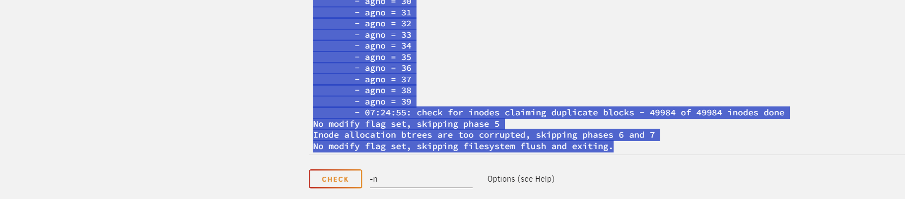

here is the command after I put -n command
for the next step please tell me what is the command, Thanks

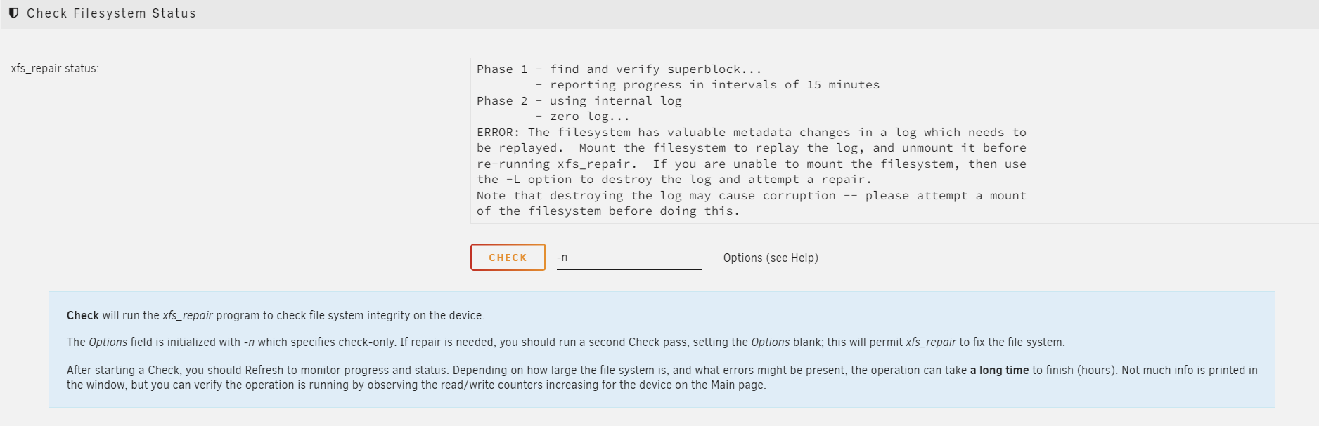

Check filesystem on disk2 from the webUI without -n. If it asks for it use -L. Capture the output and post it.
attached check without -n asks for -L command
