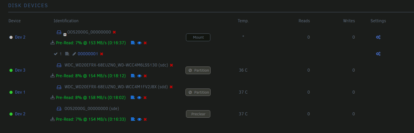

I cant add the Seagate disks properly (WD is working). I can only select one SG disks the other is mounted/connected and working but not displayed for dropdown selection in array GUI.
Most of the time its displayed like this.

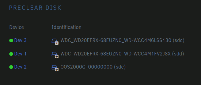

Sometimes i can also see the 4th disk like this:
Log entries say:

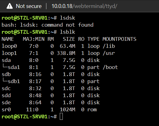

Terminal output of lsdsk:
image.png.732d18439f805b286829694a587523ba.pngimage.png.ccb9a99d671d3838f6730ee2dba551e7.png
sda1 is USB stick (boot)
sdb is already formatted.

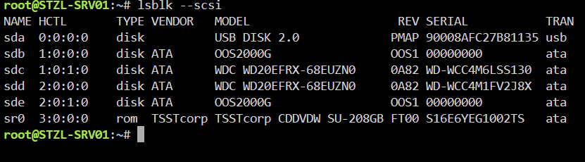

In the 2nd screenshot we can see that the OS HDDs arent really getting detected right by Unraid (Serial 00000000? Wtf? :D)

Unraid requires that all devices have a unique serial number, the OOS2000G devices both have the same serial, so you only be able to use one at a time with Unraid.
