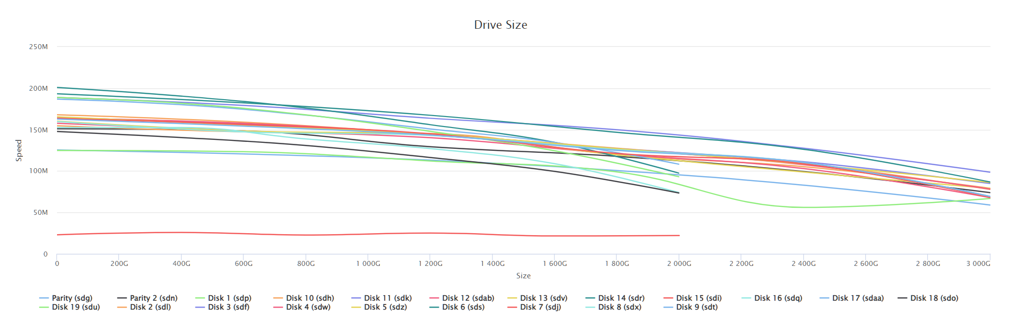

Well I got it running with some help from @jbartlett. I ran the benchmark and ended up with the following. It looks like Disk 15 (sdi) was the issue. I replaced it with another drive I had and the data rebuild is currentlyrunning at ~90MB/sec!
Thanks for your help!
I'd keep an eye out on that green one with the dip at the end, especially if it's the same model as the others. If another benchmark on that drive shows the same speeds, you will be limited by that drive like you were by sdi. Parity will follow the speeds of the lowest/slowest drive.
Keep in mind that you'll also want to do a controller benchmark (click the i icon to the right of the controller label). It doesn't matter how fast your drives are, if they can serve up data faster than your controller can handle, it won't be able to keep up with all drives active. The screenshot by JorgeB is an example of this. Note that this is really only a hindrance during parity or other highly data intensive operations, you'll likely never run into this issue otherwise.
Edited by jbartlett
