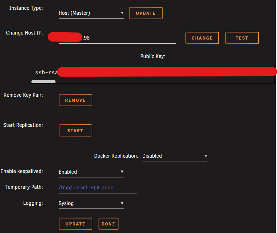

Yeah, I think I've got it sorted at this point. Keepalived is configured on both, master registers as master and backup picks up when master goes offline.
I am having one issue though - it seems any time keepalived does anything on the backup server, it shuts down all the containers that are running.

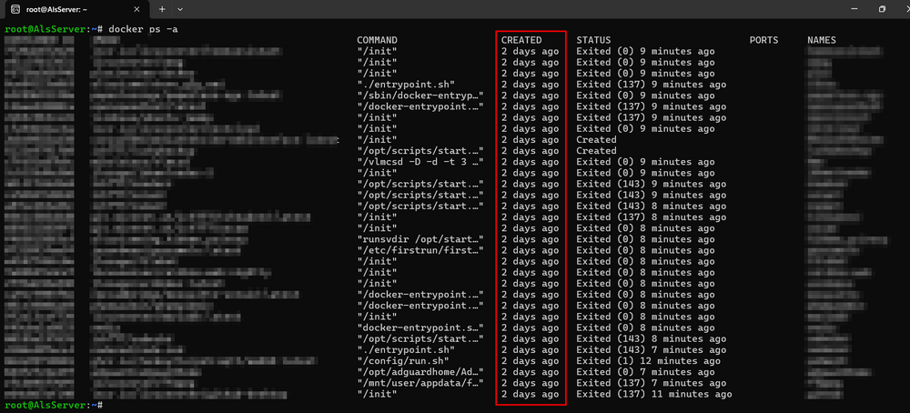

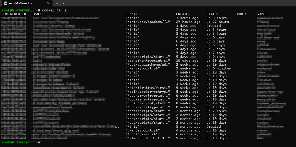

I'm sorry, I wasn't clear - non-replicated containers on the backup server are shutting down whenever the master goes offline.
My backup server is a game server, not a dedicated backup, so it's running some other stuff - Teamspeak, Crafty and the like. I do see the replicated containers in the list where they belong. But when the master goes offline, the backup seems to shut down all running containers.

That's a bummer. So what's happening is:
Master Server:
Non-replicated containers: UP
Replicated containers: UP
Backup Server:
Replicated containers: DOWN
!!! EVENT - MASTER OFFLINE !!!
Master Server: OFFLINE
Backup Server:
!!! EVENT - MASTER ONLINE !!!
Master Server:
Backup Server:
Non-replicated containers: DOWN
The plugin is stopping all containers on the backup server once the master becomes available.
This is a minor inconvenience for me because my backup server is a gaming server and isn't running anything important. However, it is an annoying additional touchpoint after a failover. The stopped non-replicated containers do not come back up even if set for --restart always.
