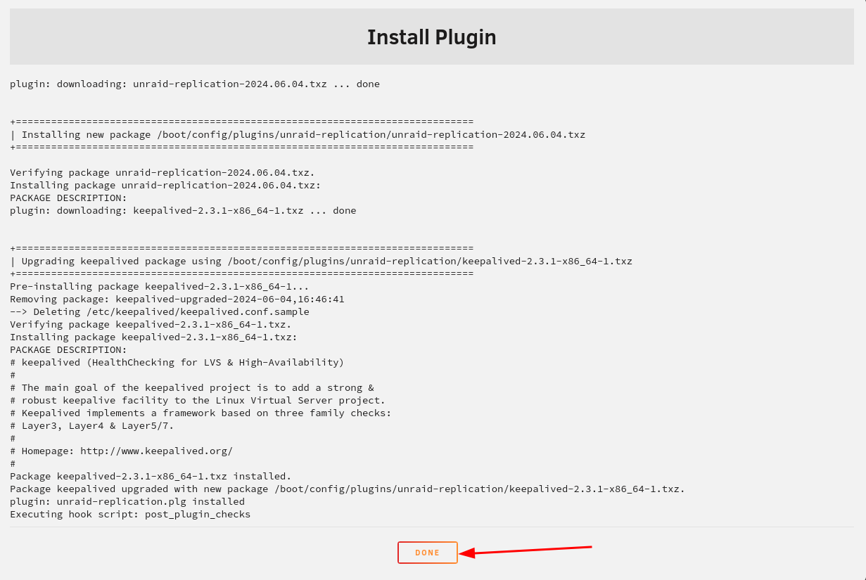

  1. Install the plugin on both servers through the CA App by searching "Unraid Replication" and wait for the Done button:

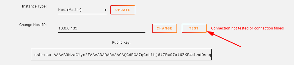

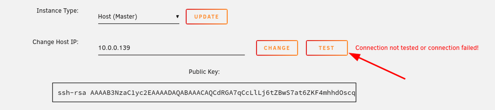

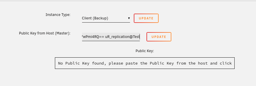

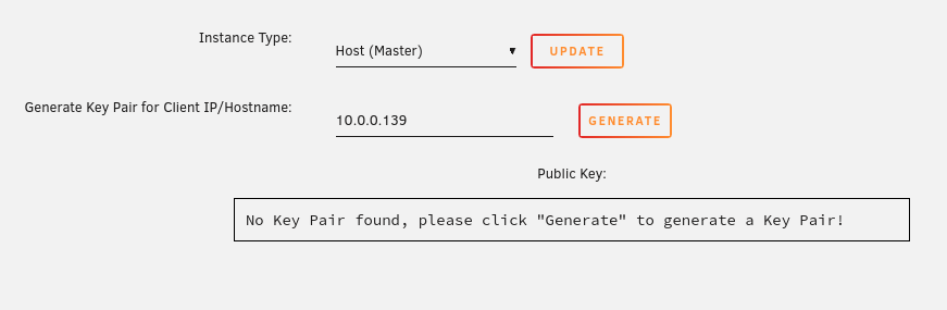

  4. Generate a Key Pair on the Master server by entering the IP address from the Backup server and click Generate (in this case the Backup server has the IP address 10.0.0.139) :
  5. Triple click the now generated Public Key on the Master server, copy it into the clipboard, past it in the field "Public Key from Host (Master)" on the Backup server and click Update:

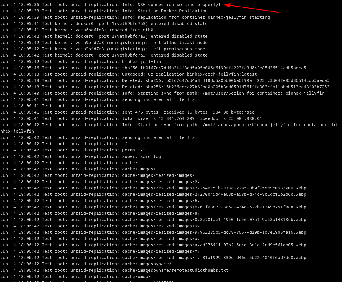

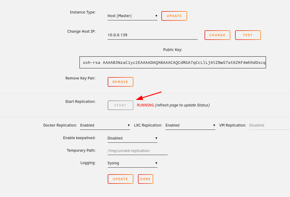

  6. Let's test the connection on the Master server by clicking "Test":
    You should get a popup that says "Info: SSH connection working properly!" (if you get an error make sure that you have SSH enabled on both the Master and Backup server) :

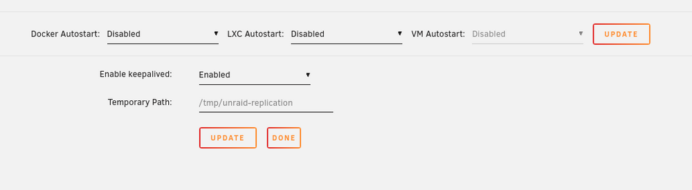

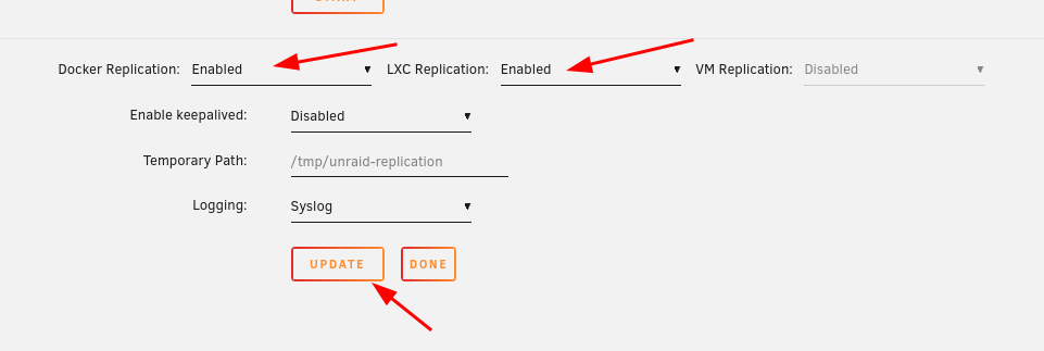

  7. On the Master server select if you want to replicate Docker and/or LXC and click Update (if you want you can also change the Logging type from Syslog to File -> the log file will be written to: /var/log/unraid-replication) :
    Note about Temporary Path: If you leave the Temporary Path empty the default path '/tmp/unraid-replication' will be used.
    In most cases the default path is sufficient, if you are low on RAM you should set a different path since the Docker Replication (if enabled) will copy the container layers to this path from the Master server (one by one and it will at most always be one container backup in the temporary path), most containers should not consume more than 1GB of RAM but please always check for exceptions, especially for LXC this can be a different story and a container image can consume a few GB of RAM if you leave the default path.
    However I would recommend for now to leave it empty until more testing is done, if you are brave enough feel free to test it and let me know if you encounter any bugs/issues.

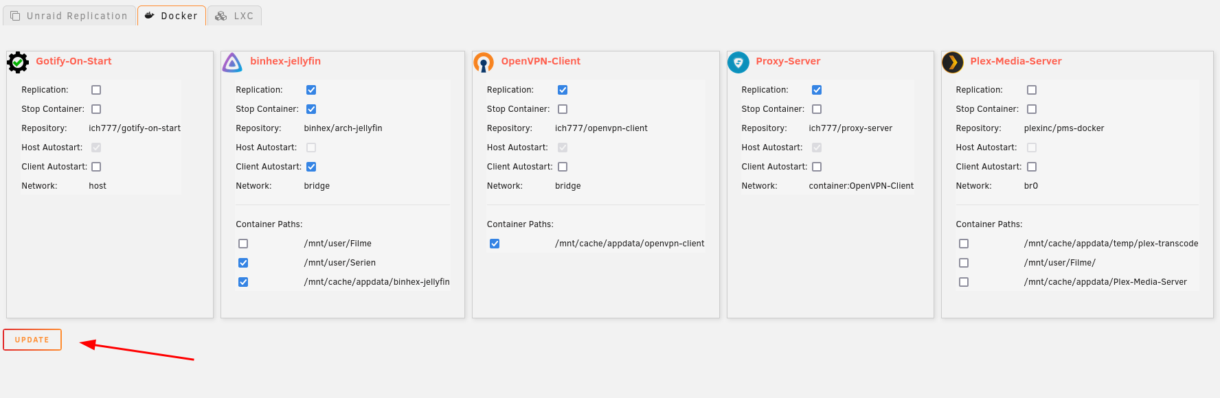

  8. Go to the Docker tab within the plugin on the Master server and select your containers that you want to replicate alongside with the path, if you wish to enable Autostart on the client and click Update (Autostart only applies if you use keepalived since containers on the Backup server will not automatically start by default to avoid conflicts in your network but Autostart will work if you use keepalived) :
    Replication: Enable if you want to replicate the container
    Stop Container: Will stop the container while replicating (Recommended! If you don't choose to stop the container a snapshot will be taken <- this means the container will be paused for a few seconds to be able to take the snapshot)
    Host Austoart: This shows you if Autostart on the Master server is enabled
    Client Autostart: This will let the Backup server know if the container should be auto-started when the Master server is not available. You can also enable Autostart for a container that does not Autostart on the Master server (Client Austoart only applies if you are using keepalived).
    Container paths: Choose your container paths that you want to sync (rsync is used to sync the data).
    Please note that the base path in my case /mnt/cache (for/mnt/user/appdata) or /mnt/user (for /mnt/user/Serien) needs to exist on the Backup server before starting the sync otherwise the path will be discarded while syncing.
    Note: If you choose to stop the container the container will start after the replication from the Docker image layers and the selected container paths, however I strongly recommend to stop the container since you can destroy a database when it's in the middle of writing data.

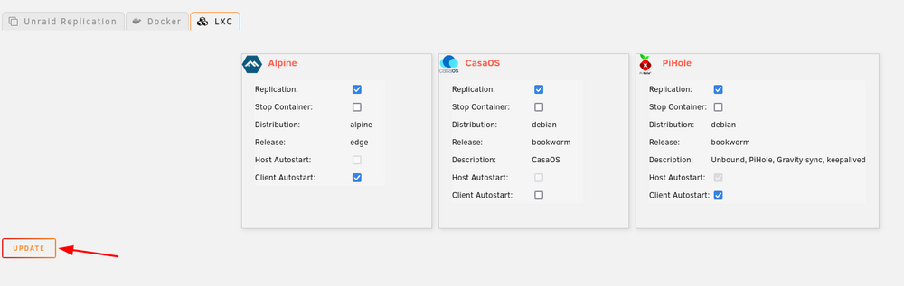

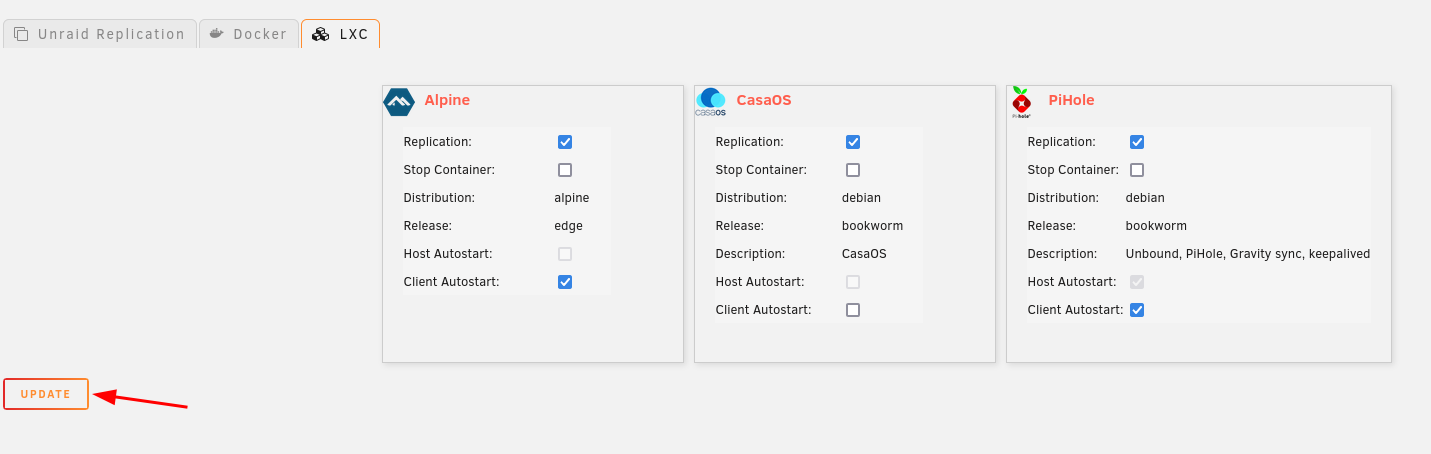

  9. Select your LXC containers (if enabled) and click Update:
    !!! PLEASE NOTE THAT REPLICATION CURRENTLY IS ONLY WORKING IF YOU ARE USING BTRFS AS THE BACKING STORAGE TYPE !!!
    (ZFS will be implemented in on of the next releases)
    Stop Container: Will stop the container while replicating (Recommended! If you don't choose to stop the container a snapshot will be taken in running state and could lead to data corruption)

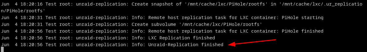

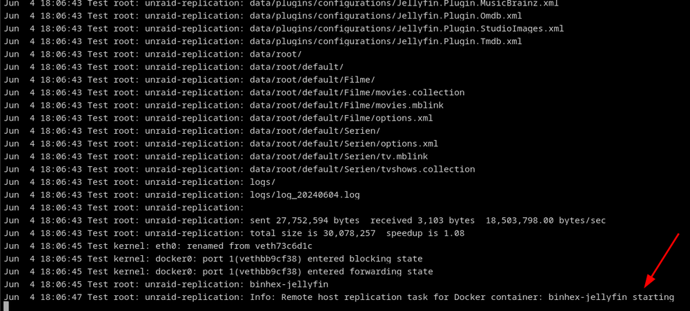

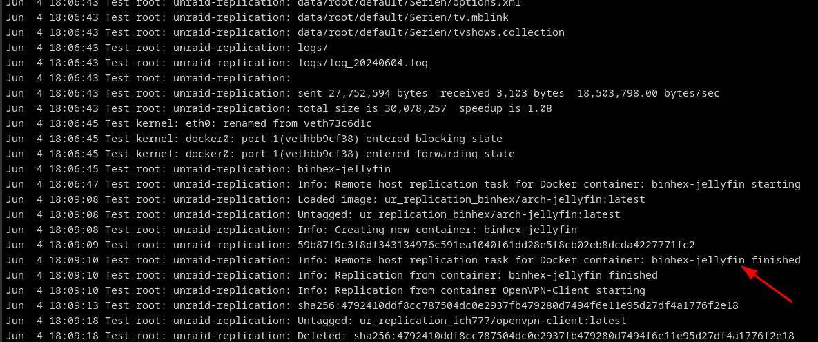

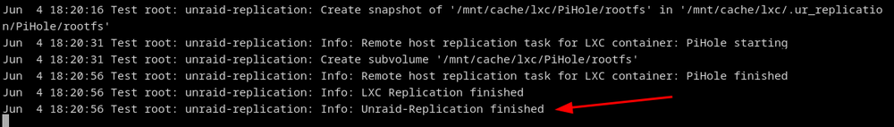

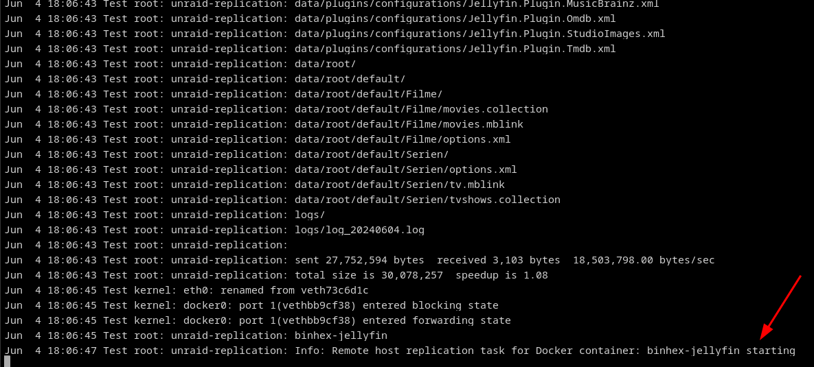

  10. On the Master server go back to the Unraid Replication tab and click Start at "Start Replication", this will initiate the replication and you can watch the progress in the syslog (Icon in the top right corner from the unRAID WebGUI: grafik.png.1defeed64fa15b9155878fde732a7cff.png), if you didn't change the Logging Type above:
    This should give you something like that in your syslog:
    After everything finished on the Master server you will see that a task on the Backup server is started:
    After the task on the Backup server finished you will see:
    When the replication is finished you get this message:

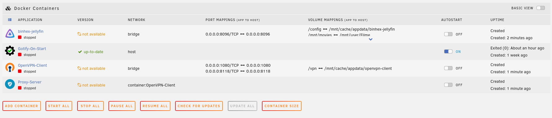

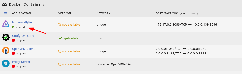

  11. After the replication task finished you can go to the Docker page form the Backup server and you should see your synced containers:
    Please don't worry about the version saying "not available" this is caused because the Docker layers are replicated from the Master server to the Backup server.
    The Autostart from all replicated containers as you can see is also disabled, this is done on purpose and will be handled by keepalived if used, otherwise containers will start and possible cause conflicts on your network.
    (The container Gotiry-On-Start was not replicated, that's why you see Autostart enabled)

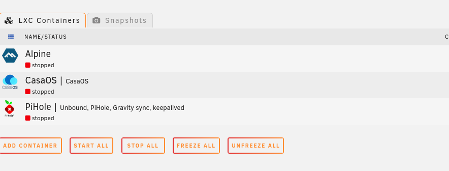

  12. The same applies to your LXC page on the Backup server:

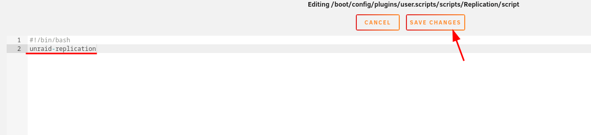

Running on a schedule:

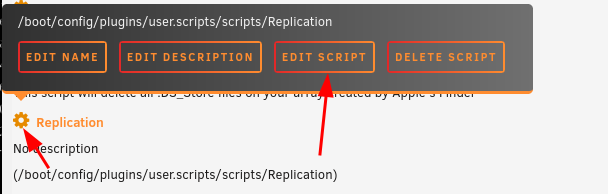

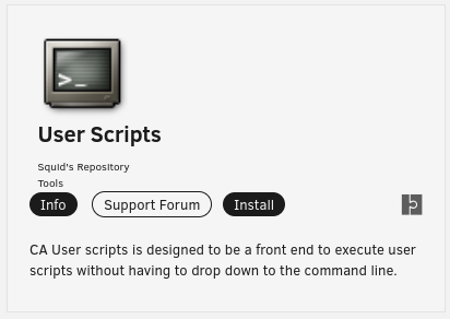

  1. On the Master server, go to the CA App and search for "User Scripts" from @Squid and install it:
  2. Go to Settings -> User Scripts:
  3. Click "Add new Script":
  4. Give it a good name:
  5. Hover over the Gear icon and click "Edit Script":
  6. Add the line "unraid-replication" (without double quotes) right below the line "#!/bin/bash" and click "Save Changes":
  7. Select your preferred schedule or create your custom one:
    (I wouldn't recommend to run it too often because you will obviously cause some strain on your disks/network when replicating, personally I run it once a day but you can of course run it every hour or however you prefer it)
  8. Click Apply:
    The script will now run on your set schedule.

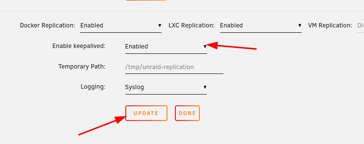

  1. On the Master server go to the plugin (Settings -> Unraid Replication) :

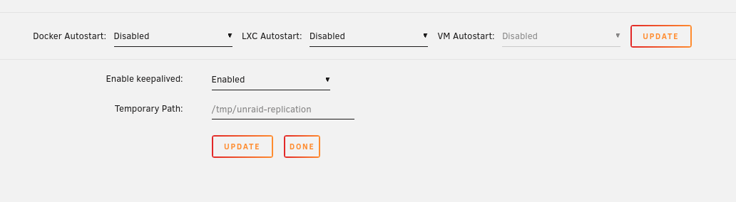

  2. Enable keepalived and click Update:

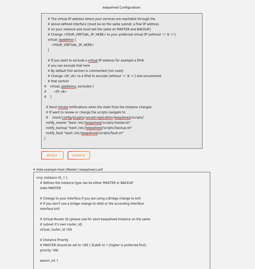

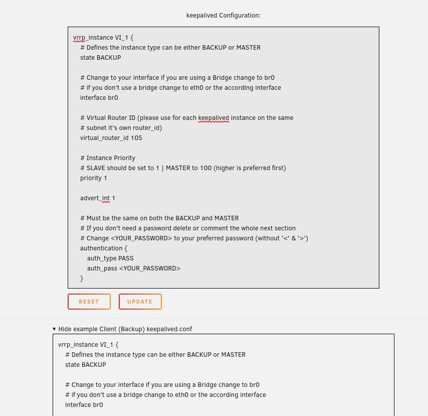

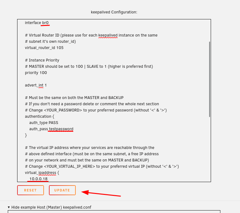

  4. Click on "Show Host (Master) keepalived.conf example to open the spoiler at the boot from the page:
  5. Copy the whole config example configuration and paste it in the text box above:

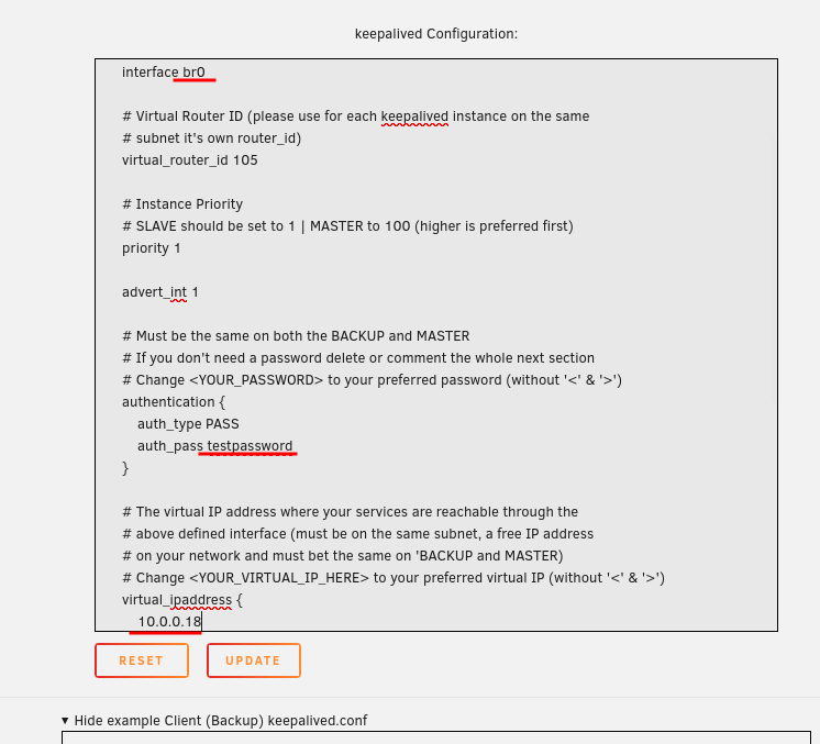

  6. Please make sure that you change the configuration example so that it fit your needs (there are descriptions at each line, so I would recommend that you read through all of them).
    Especially check the interface (configured by default to use br0), you have define a virtual IP address (which is a free IP address on your network and not used by anything -  in my case 10.0.0.18) and set a auth-pass password (or remove the authentication section entirely - in my case testpassword)
    After you configured everything click Update:

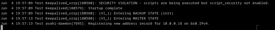

  7. Shortly after you clicked Update you should get a notification from keepalived through the Unraid notification system that it registered as Master server:
    This should be also be reflected in your syslog:

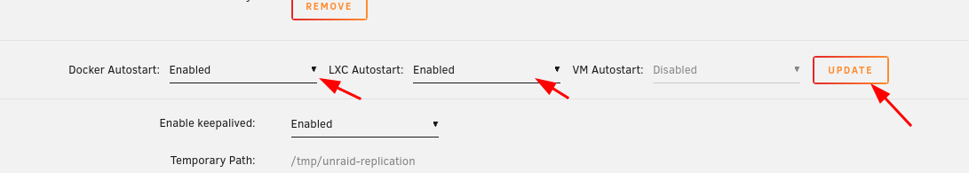

  8. Now move on to the Backup server and go to the Unraid Replication plugin, enable keepalived and click Update like described above for the Master server and you should see something like that:
  9. Enable now the Autostart from the services that you want to autostart and click Update:
  10. Go now to the keepalived tab on the Backup server, click "Show Client (Backup) keepalived.conf example" and copy paste the whole example in the text box above:
  11. Please make also sure that you change the configuration example so that it fit your needs (there are descriptions at each line, so I would recommend that you read through all of them).
    Especially check the interface (configured by default to use br0), you have define a virtual IP address (this MUST be the same IP address as you specified on the Master server - in my case 10.0.0.18) and set a auth-pass password (this MUST be the password as you specified on the Master server - in my case 10.0.0.18)

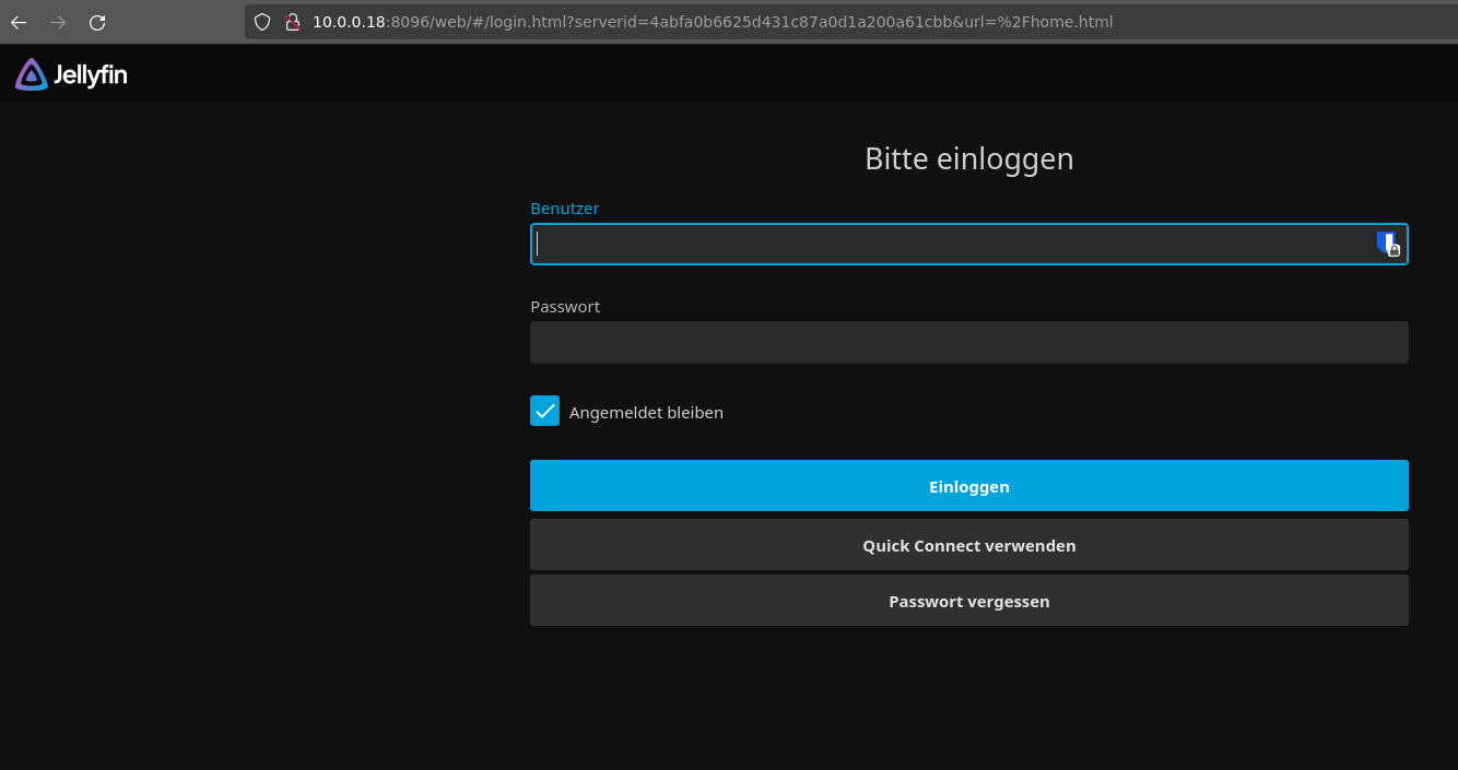

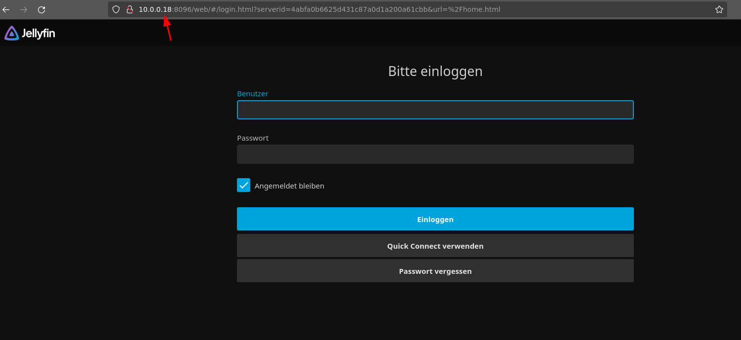

With that you have now configured keepalived and you should now be able to reach your services (if they are running on the default or custom bridge from Docker without a dedicated IP on the physical interface) with your virtual IP address - in my case 10.0.0.18 (for example binhex-jellyfin) :
When the Master server for whatever reason goes down you will shortly after it goes down get another notification from the Backup server that the Master server is not reachable:
If you've enabled Autostart in Step 9. keepalived will automatically start the containers that have Autostart enabled on the Backup server:
And you then will be still be able to connect to the container through the virtual IP address - in my case 10.0.0.18:
Note: It might be necessary to re-login on web applications because the connection drops for a few seconds and the container from the Backup server has initially no clue that something is/was connected.
Note: In the case for Jellyfin I had to set a static hostname for the container so that the WebGUI doesn't complain about a different hostname, simply do this in the Docker template with Advanced View enabled and add:
--hostname=jellyfin
to the Extra Parameters:
After the Master server is back online you will get a notification on the Backup server that it is now available again and stop all containers on the Backup server and start them as usual on the Master server:
and the on the Master server you'll get this notification:
Your applications are now still available at 10.0.0.18 (if Autostart on the Master server is enabled).

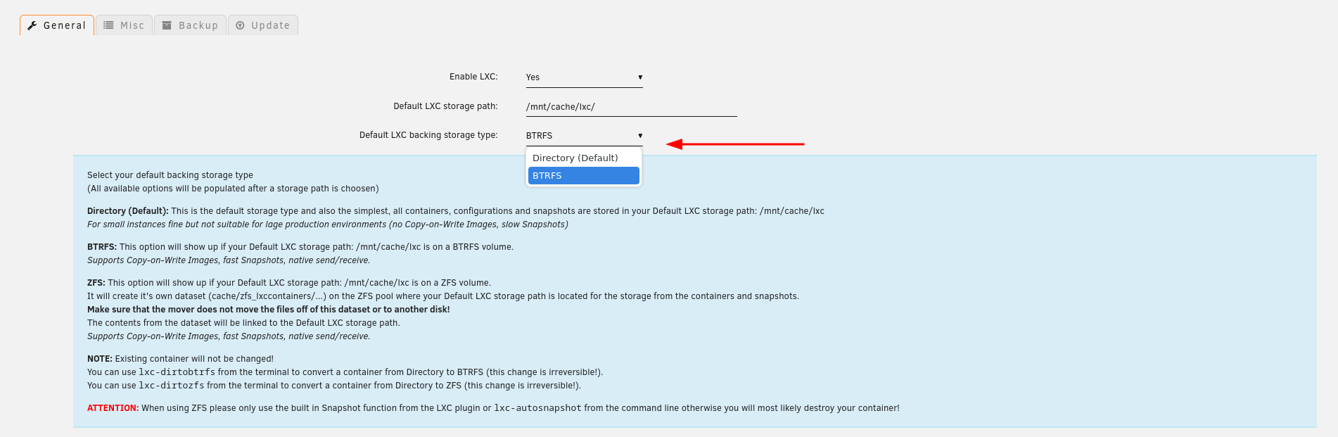

Working great! However, I installed LXC after installing this plugin and can't get the replication plugin to recognize i now have LXCs for replication. I tried uninstalling this plugin and reinstalling but it is still only detecting dockers.
Can you please post your Diagnostics?
What backing storage type do you have configured in LXC (please not that currently only BTRFS is supported)?
Ah, yeah the host (master) FS is ZFS. On the backup it's btrfs. Docker replication works great.
mars-diagnostics-20240630-1354.zip
Edited by ffhelllskjdje
Just as a side note, your default backing storage type is directory and not ZFS, you can change that in the LXC Settings:
Keep in mind I don't plan to make it possible to copy from a ZFS to a BTRFS backing storage type since then this wouldn't be replication... :)
However replication from ZFS and Directory backing storage type are both coming, but will still take a bit.

6 minutes ago, ALERT said:
But now, as the replication succeeded, I wish to abandon my essentials on my main server and fully use them on my mini server, but the container versions are "not available".
This is caused because the container where not pulled from Docker Hub directly.
I think if you click "Force Update" with Advanced View enabled on the Docker page it should hopefully update the status from the containers.
Otherwise you have to go into each container template, make a dummy change (to make the Apply button clickable), change the dummy change back and click Apply, that should also do the job.
What you can also try is to wait a day or two and see if the status changes <- if you enabled automatic update check.
(Please keep in mind that you are already on the latest release from the container since you've replicated them)
Silly me, I didn't manage to think about clicking Force Update myself. Thank you! It worked!
Dummy change didn't work, btw.
Edited by ALERT
