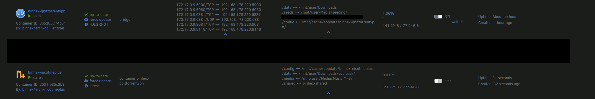

Here an overview of those dockers.
EDIT: I have removed the cloudflare options, so it is only accessible from inside the home network.
And I've edited LAN_NETWORK to the right ip address, now it gives me "RFB 003.008" in plain text.
Edited by rikdegraaff
See EDIT

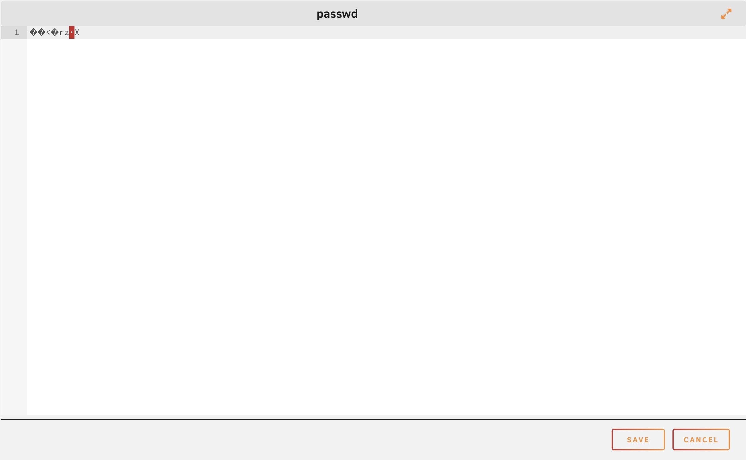

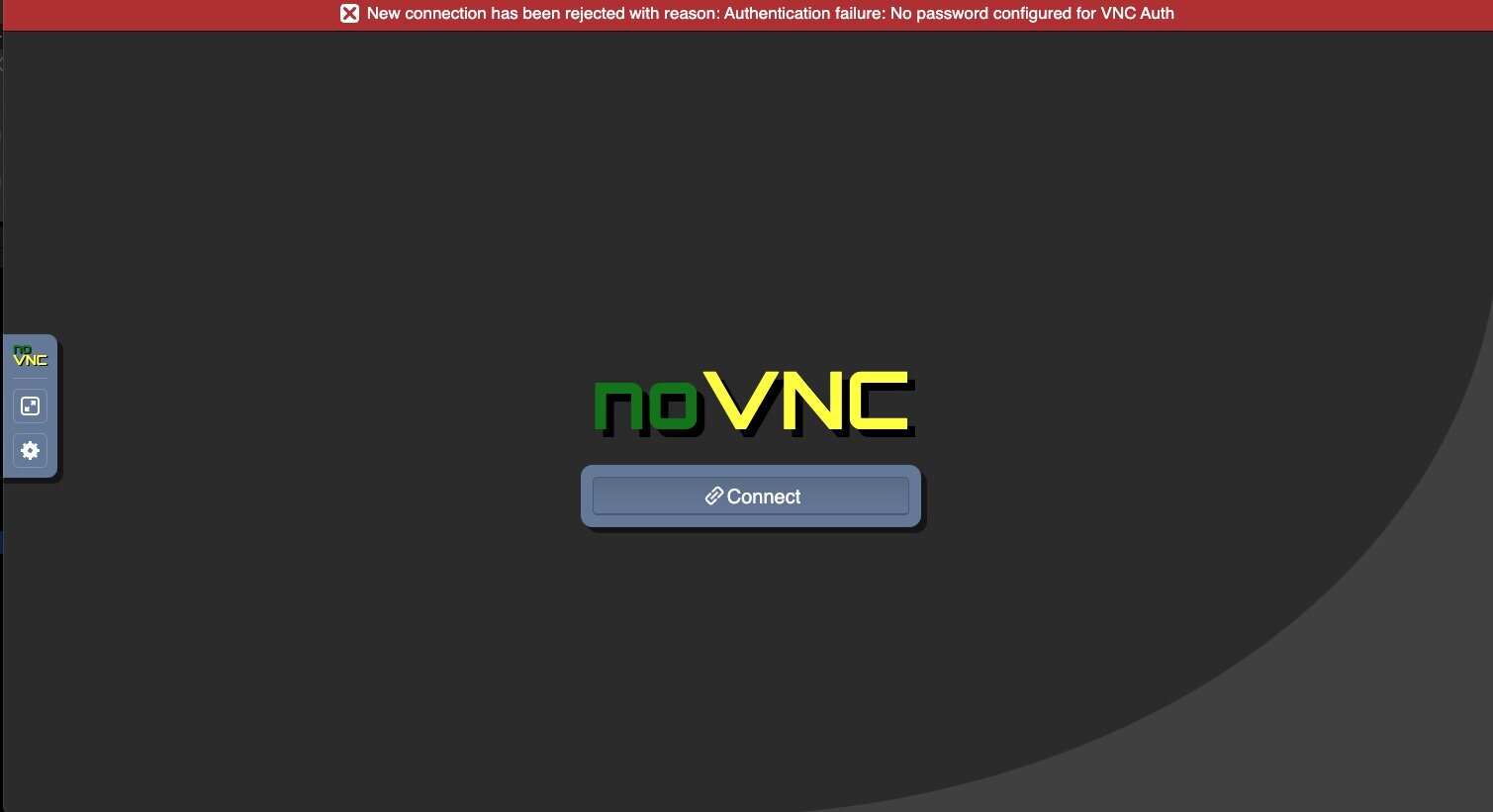

Hi there @binhex, I have an issue that I'd appreciate some support with.
I just tried accessing the container as normal using the WebUI, with the URL http://192.168.0.229:6082/vnc.html?resize=remote&host=192.168.0.229&port=6082&autoconnect=1
I have never had an issue using this until today, and as far as I'm aware nothing has changed about my setup.
Despite my password 100% being "password", now when I try entering that into the login page I get this error: "New connection has been rejected with reason: Authentication failure: No password configured for VNC Auth"
I have tried resetting the password in the Docker container settings, but this has not helped.

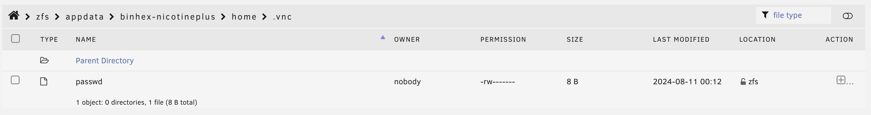

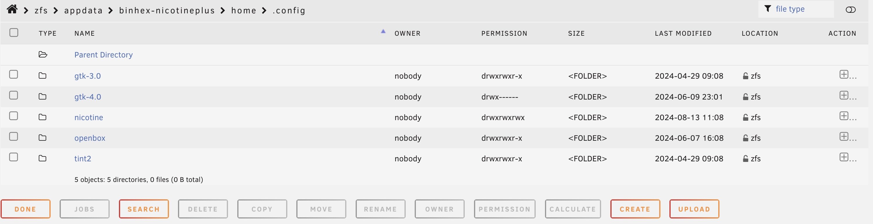

Interestingly I can't see a /tigervnc folder in the location you specified:
There is this however:
ok i have added in some additional code to ensure the path exists and to hard set the path for the password file, please can you pull down latest (force update).
Ah awesome, that worked! Thanks a lot
