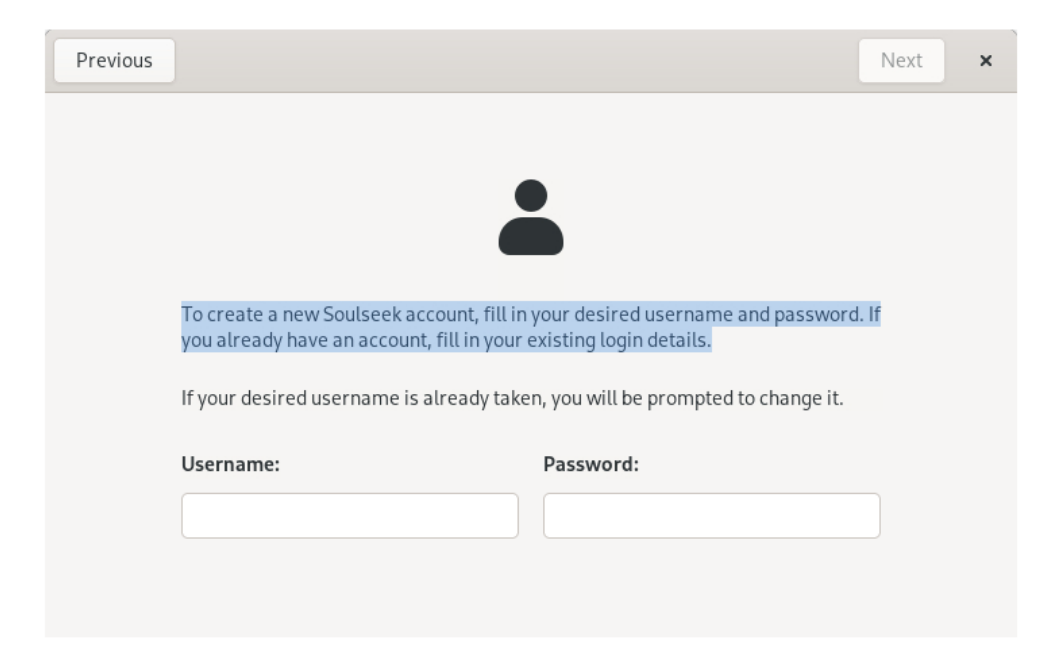

@binhex, I get the following error/note/warning from N+, and it doesn't start.
It stays at the following message:
You need to specify a username and password before connecting…
What can I do? I don't see in the template any username password field.
Thanks in advance!
Thanks in advance!
same here...

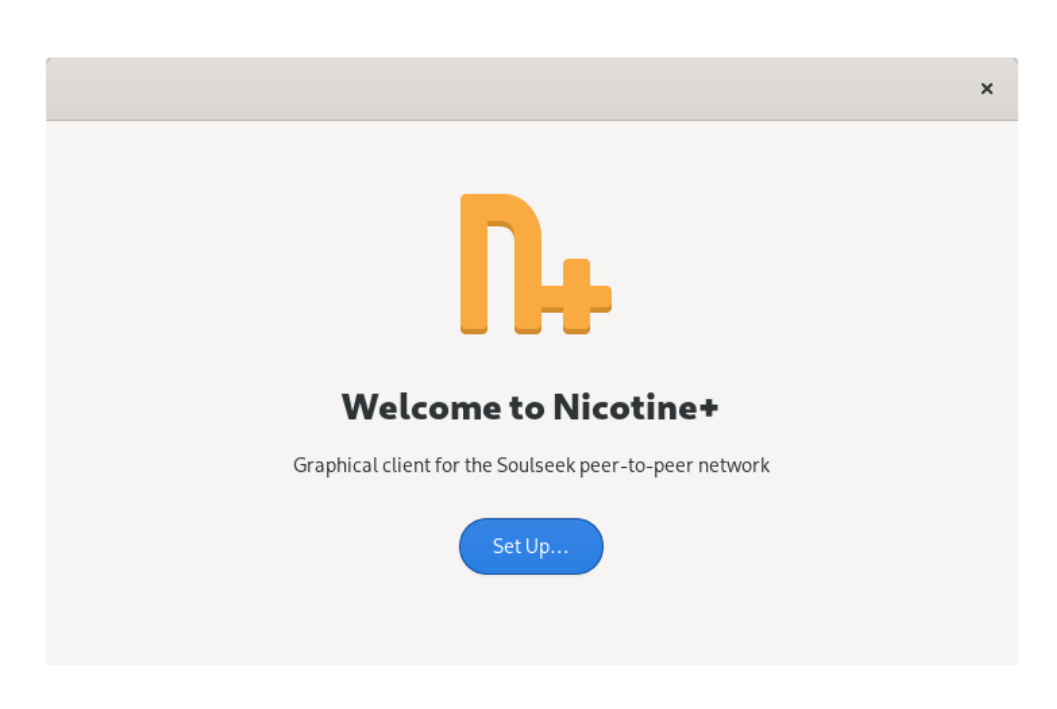

are you guys not seeing the wizard on initial startup of nicotine+ where it asks you to create a username and password? screenshots from the container:-
so basically enter in whatever username and password you like, obviously you will need to have a unique username that is not already in use and you should be good!.
