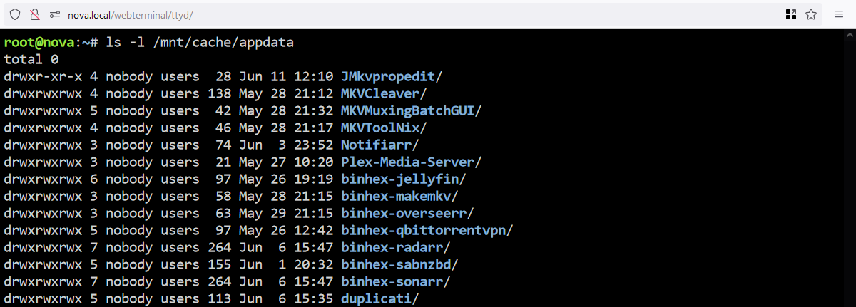

I recently reinstalled Unraid because I was having some problems. I still have the appdata folder and I have restored it, but now Unraid says the configuration files cannot be found.
I still have a flash backup, but I don't know which file/s I need to restore the configuration file/s for the docker images.

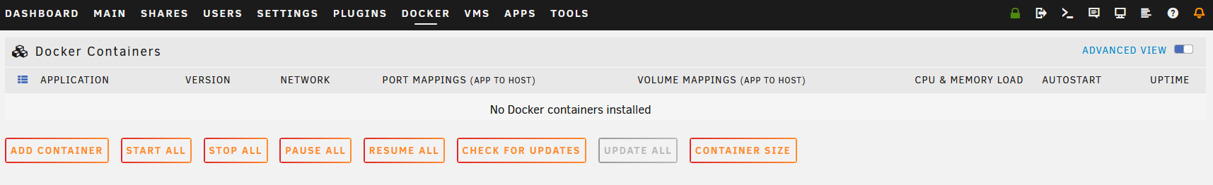

The list of Docker installs is blank, but I have copied the app data content from the backup. What's going on?
I also copied everything under \config\plugins\dockerMan to the flash drive and rebooted.
What am I missing?

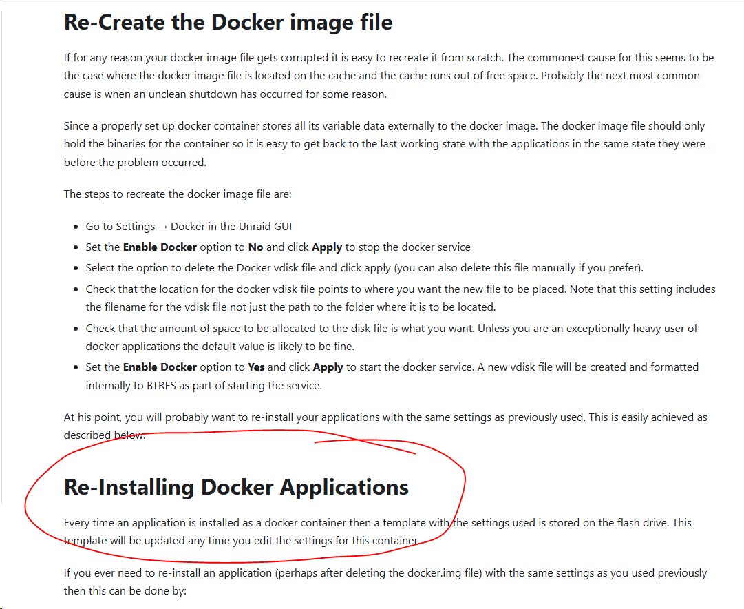

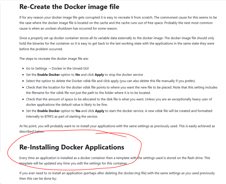

Did you restore the containers from Apps?
What does that mean? Install them again manually?
See the link above.
I am confused. The first article?
Where does it explain that?
First explains how to first recreate the docker image file and then the next section explains how to reinstall docker applications with previous settings.

For future Unraiders the solution was namely to do as jorgeB mentioned, but more specifically:
  1. Copy the contents of the backed-up appdata to the production version of appdata
  2. Copy the contents of config/plugins/dockerMan from your backed-up flash drive to /config/plugins/dockerMan on the production flash drive.
  3. Re-create the docker image file.
  4. Re-install the previous docker applications
