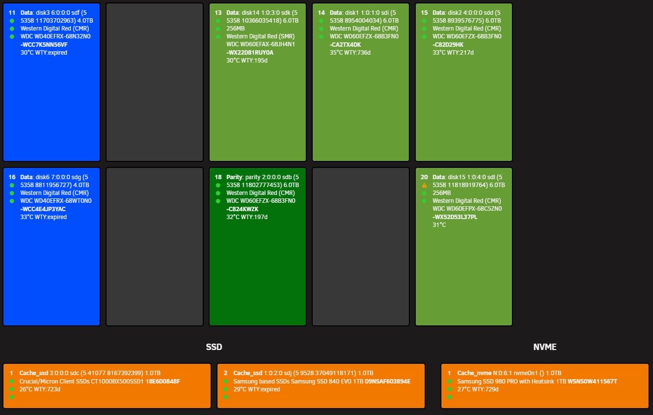

I’ve been chasing this problem for months now.  Drive 15 is my second youngest drive in the system, it’s just over year old. Drive 15 periodically reports errors but every SMART test run, comes back clean. I’ve replaced the breakout cables for the LBA card, I’ve replaced the LBA card, I’ve replaced the CPU, I even tried a new drive in different slots and got the same errors. I installed an additional fan blowing directly on the heatsink of the LBA card.  I ordered a new power supply that will be here tomorrow, that’s the last thing I can think of that may be the issue.
drive 15 is the drive that keeps reporting errors.  I’ve tried it in two different 5 in 3 enclosures, every free slot with the same results. Sometimes, after I try to rebuild the data from parity, it will finish and be okay for a week or two then reports errors again. Sometimes, the rebuilds fail, it reports errors, disables the drive, then it shows up on unassigned devices.
I am currently trying to rebuild the drive again and was waiting to see if it would error out again but noticed some weird things in the syslog, so I decided to go ahead and make a post.  Could all of this be because of a failing PSU?  I usually am able to solve any issues by referencing others posts and have waited to post this but I need some help.

Thus far, I've tried replacing the following to solve this issue:
Power supply (Seasonic 660W to Seasonic 850W)
CPU (Xeon 1275v3 to Xeon 1285v3)
LBA card (LSI 9207 to 9211)
LBA breakout cables
the HDD (whatever drive installed as 15 always ends up with write errors)
Installed a fan blowing directly on the LBA card heatsink
At this point, I have no ideas left to try.
mrpunrfsx1-diagnostics-20240823-1710.zip

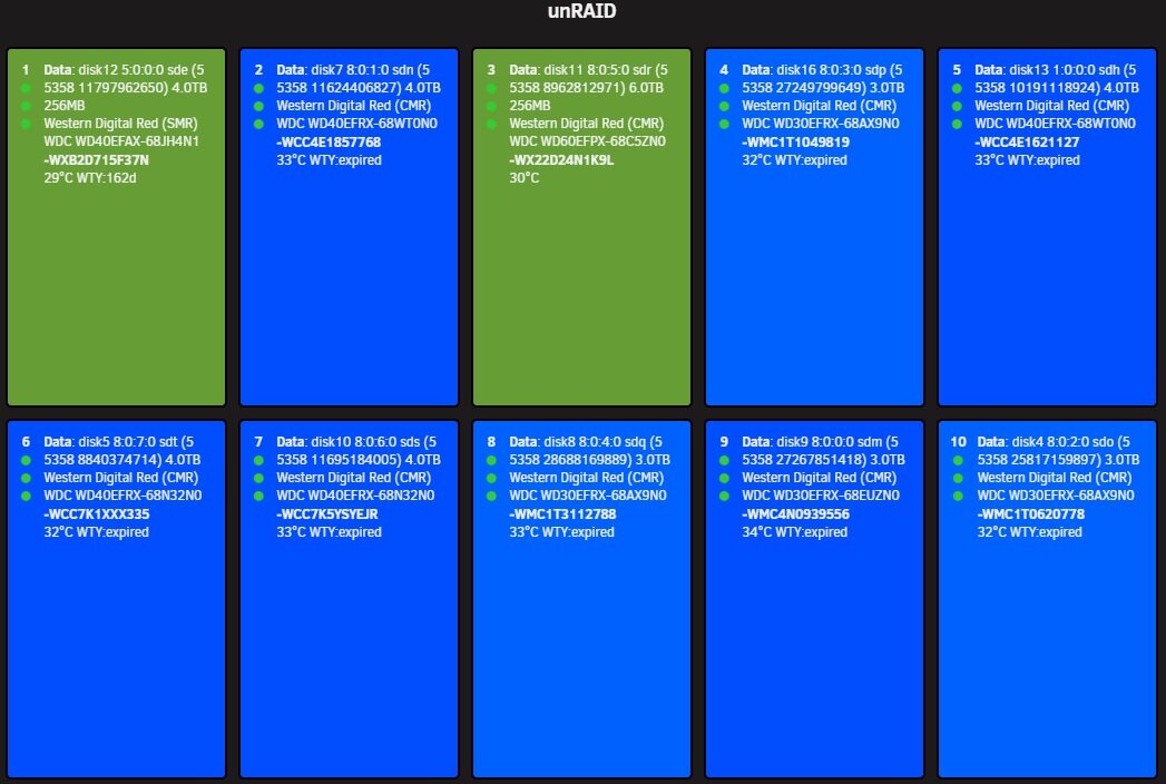

Okay, I re-cabled the entire system.  Since I replaced the Seasonic with another Seasonic, the ports for the various cables matched so I didn't replace all the power cabling but I went ahead and did that today, paying special attention to the power cables to the 5 in 3 cages.  After doing that, I tried to rebuild the drive, it had errors again.  I've tried multiple drives in two different cages and 4 different slots in the system, I have four 5 in 3 cages in the case.  I decided to take those out of the equation.  With the new power supply I have an extra SATA power port (6x instead of 5x) so I've hooked the drive up directly to the LBA card and on its own power cable and attempting to rebuild the data in a configuration that removes the cages from the path.  I'll let you know if it makes any difference and post the diagnostics if it doesn't.
4 hours ago, prongATO said:
replacement for disk 15 and it exhibited the same behavior.
That's good, so problem not related to disk itself because no problem when it be disk11.
Due to problem stick to disk 15, would you try empty slot 15 and temporary assign the disk to i.e. 17.
This iused to rule out does something affect disk15 only, as you use single parity so this no hurt to reassign data disk.
Edited by Vr2Io

See the attached images for the layout of my drives in the cages.  the NVMe SSD is in an addon card and the SATA SSDs are attached to a card that sits in an open pci slot but isn't "plugged in" so I didn't have to use up spots in the 5 in 3s.
Green: drive under warranty
Blue: drive out of warranty
Dark Green: Parity
Orange: SSD/NVMe
Edited by prongATO
explain layout
