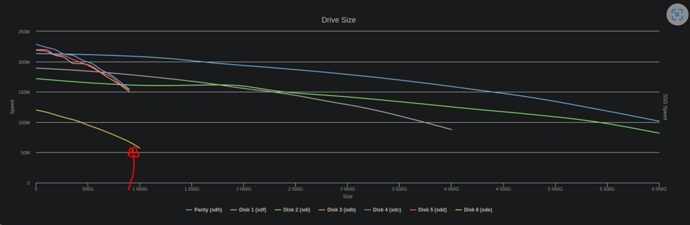

This diskspeed graph posted by another user can give a better idea, say you are writing to disk4 just before the 1TB mark with turbo write, max speed will be around 55MB/s, limited by disk6 read speed:

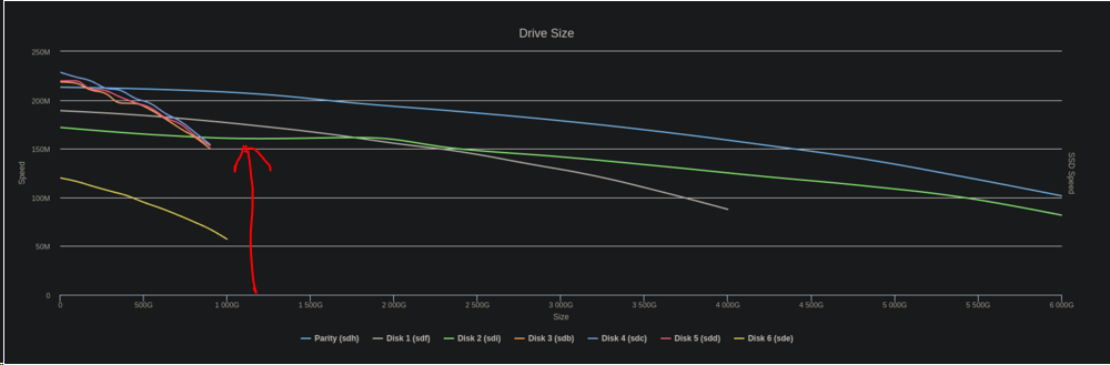

If you write to the same disk4 just after the 1TB mark, max speed will be around 160MB/s:
