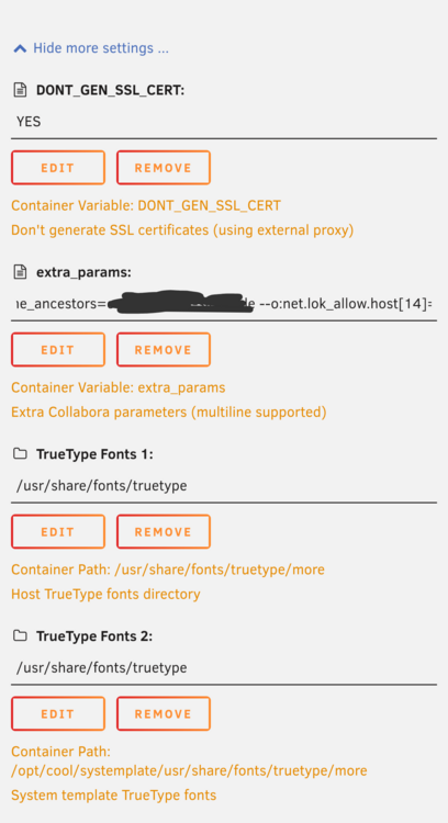

If you install my collabora container keep an eye on the extra parameters under more settings. There are two places you need to enter your opencloud domain. It's a bit hidden, that's why I mention it.

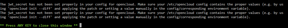

Yes. My container has the the post args.
<PostArgs>-c "opencloud init || true; opencloud server"</PostArgs>
That's important, as without init, the container can't create the opencloud.yaml
Edited by Nemu
Weird, it is blank but I can see it in code.
Really weird. But this explains the failure. The opencloud.yaml has the jwt secret, which is synced with the wopi server.
Edited by Nemu
4 minutes ago, Joloxx9 said:
I am literally following your steps. There was error with initial template but something is not clear in the description.
The first error is normal. That's what I wrote, that the opencloud.yaml gets created on first container start and can't be overwritten.
As mentioned. I always started from scratch to create the containers, when I made a mistake as it often caused issues, just overwrite, or delete the opencloud.yaml.

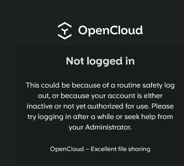

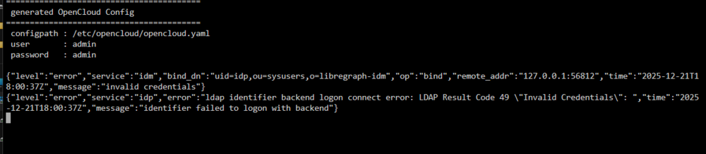

it does not accept the login/password combination, no matter what I put as a password :)
I've just tested my config with just running domains cloudflare without swag. My cloud flare domains were http to each container, and it works. So it should also work with pangolin.
Seems you have used a banned password my friend ;)
Password admin is in the banned password txt. You also need to comply to the password rules.
At least 8 characters
At least 1 lowercase letter
At least 1 uppercase letter
At least 1 digit
At least 1 special character
NOT in the banned password list
If you use a new password. Delete the opencloud.yaml before ;)

Well I put admin because mine something like "&R7$Tyklo56" was not working.
I will try once again.

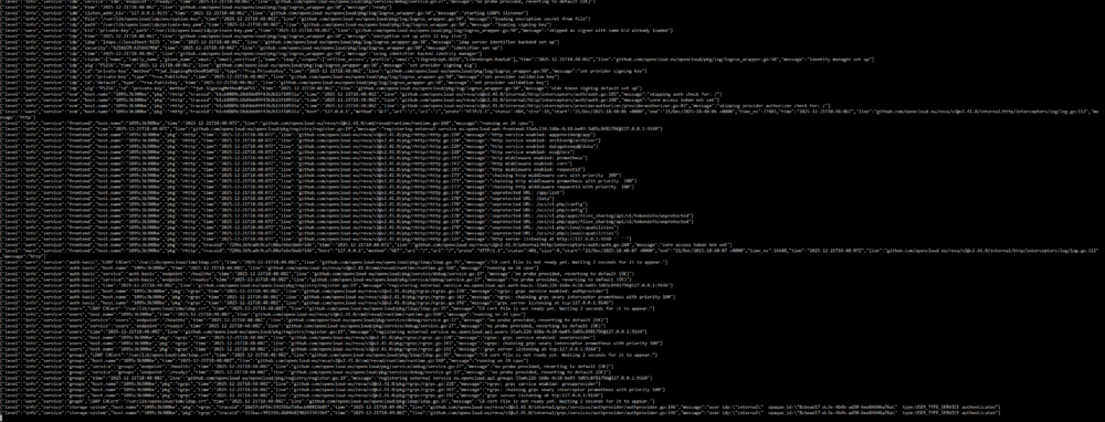

Did fresh install as it was not accepting ANY password, now I am facing this:
I literally have no clue what is going with this thing, why is it so hard to set it up?
That's a lot of info stuff. Can you access the UI?

As I'm not familiar with pangolin, I've check with AI. This is the answer. Maybe it helps?
Key Differences & Required Configuration
For Pengolin (which uses Caddy instead of nginx), you need:
1. Check Your Pengolin/Caddy Configuration
Instead of the nginx .conf files, Pengolin uses Caddy's Caddyfile syntax. You need something like this for OpenCloud:
opencloud.yourdomain.com {
reverse_proxy opencloud:9200 {
header_up X-Forwarded-Proto {scheme}
header_up X-Forwarded-Host {host}
header_up X-Real-IP {remote}
# Disable buffering for SSE
flush_interval -1
2. Critical Headers for Authentication
The login failure is almost certainly because these headers aren't being passed:
X-Forwarded-Proto (must be "https")
X-Forwarded-Host (your domain)
X-Real-IP (client IP)
hey guys.
using the info i got here and other sites
i was able to get this particular mcreekmore to work
  1. the password requirements
  2. the proper setup of proxies
  3. your proxy must NOT have block common exploits
i now have it running and connected with windows app
but onlyoffice and colabora dont seem to be present
did i do something wrong or is that separate
I think my issue is on the pangolin side at the moment.
Yes. It seems so.
1 hour ago, charettepa said:
hey guys.
For collabora you need additional containers and variables. I believe, that the mcreekmore container is for basic Opencloud at the moment.
26 minutes ago, Nemu said:
Yes. It seems so.
Yup, there was something going on between Pangolin OIDC and opencloud, had to do some rules and voila:
Perfect. 👍🏻Collabora also working?
