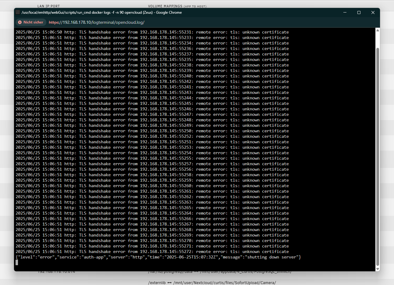

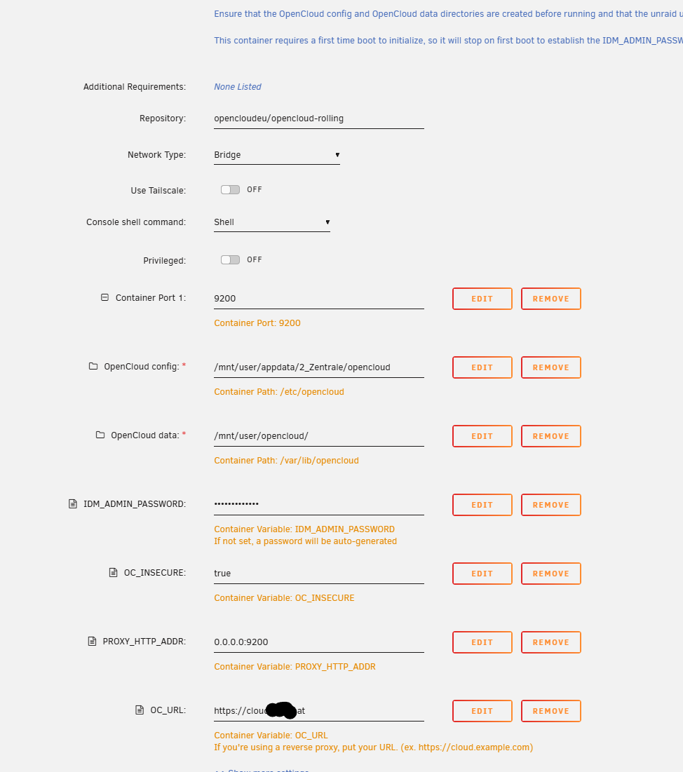

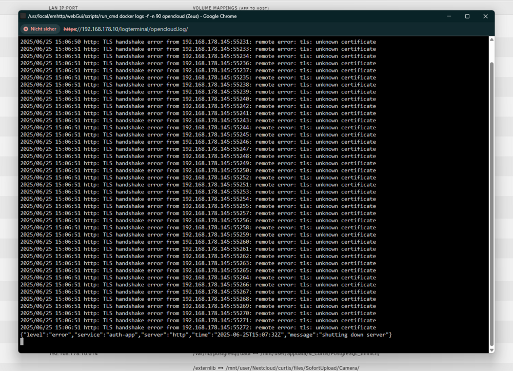

17 hours ago, Curtis777 said:
im desperste for help.
my Nextcloud is more struggle than help so i decided to give opencloud a try.
BUT
I cant get it running.
i installed the container
checked the log ( gave me the key)
removed the init and restarted
but i cant login with the local ip 192.168.178.10:9200 (missing /wrong config) or with https://cloud.mydomain.at (ERR_TOO_MANY_REDIRECTS)
npm set with standard things.
any guess where is my mistake ?
Before trying any kind of DNS configuration, try to get your frontend available within LAN.
Quoting one of the maintainer: People are always struggling with DNS, filesystem permissions and reverse proxies, which is in 90% of the cases not an openCloud problem.
To keep it simple. Please post a screenshot from:
ls -la /mnt/user/[your data folder]
ls -la /mnt/user/[your config folder]
Please also check, whether cat /etc/passwd | grep 1000 gives any respone.
Maybe this can also help: https://github.com/orgs/opencloud-eu/discussions/961
