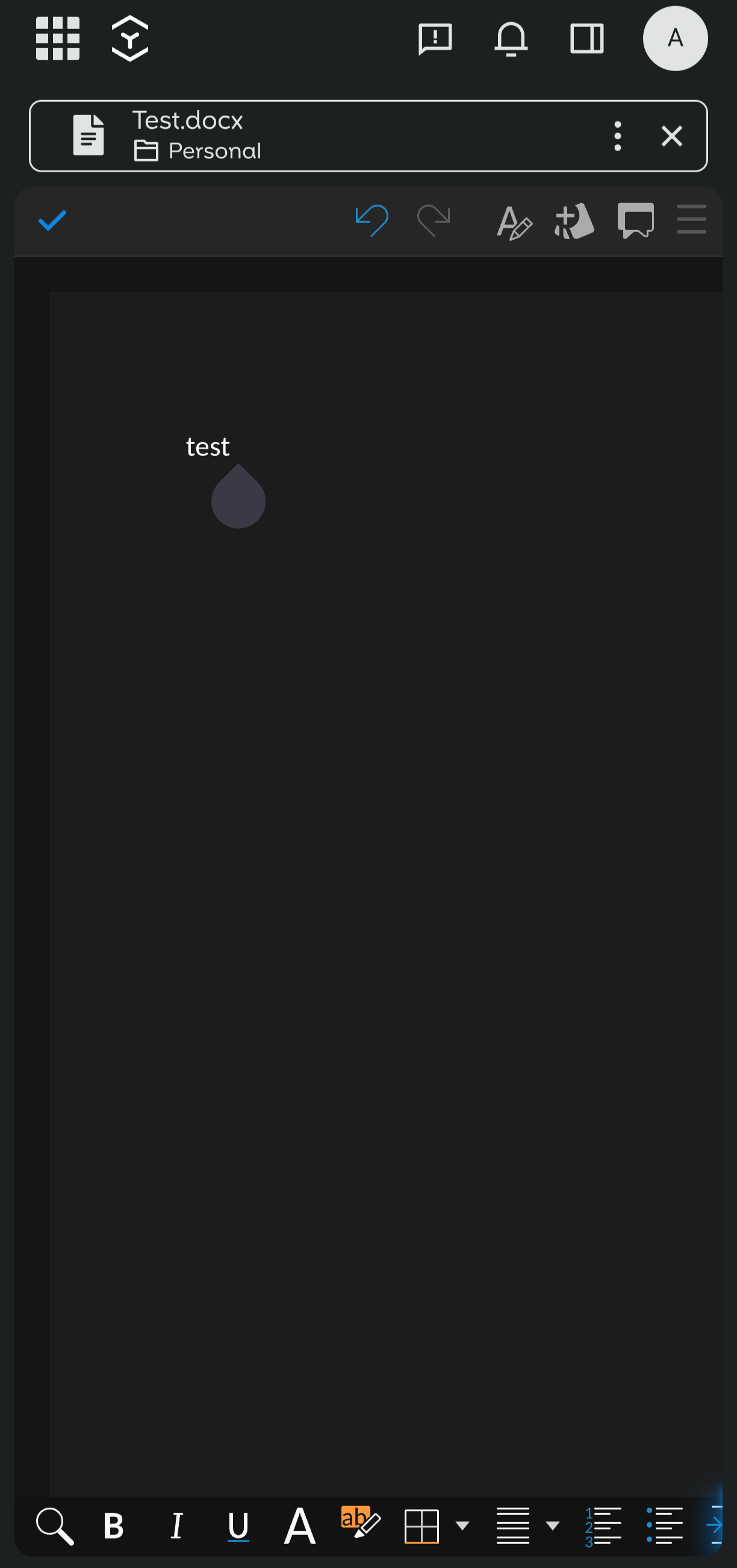

Hey guys. Short question. I've made a lot of progress running opencloud via templates. Unfortunately it needs some files to be pre placed or created via script. I have all set up but I have a question, what you prefer.
In general opencloud with additional services ( as collabora) relies on an env. file.
I can prepare two options.
  1. Adding most of the variables and ports to the template, which makes the template a bit confusing.
  2. I can make the template to read the env file, so that the user can create change all variables in the file, similar to the installation method of the official docker compose.
What I have running is opencloud, with app store and working collabora.
So overall three templates -> opencloud, collabora and wopi server.
I have also the config files for swag. Tough, I was not able to get it working with NPM, but I'm not very good in the proxy stuff.
I'm working on the remaining opencloud features as keycloak, but I can release a first version here.
Further, is anyone interested in maintaining the templates? @mcreekmore ??? Maybe together? My time is also very limited.
Edited by Nemu
