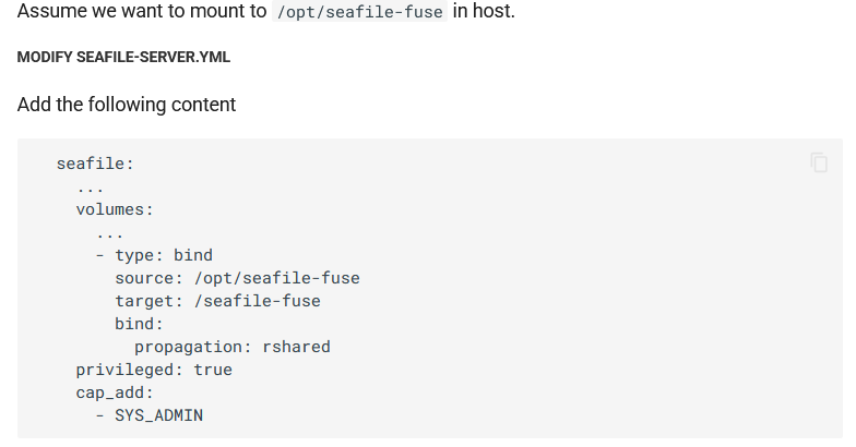

  5. Hi @Gryman ! Were you able to solve your issue? And for anyone else who might be interested: I finally managed to get Seafile’s FUSE mount working on Unraid. The official documentation here – https://manual.seafile.com/latest/extension/fuse/ – is a good starting point, but if you’re not a Docker expert and still fairly new to Unraid (like me – using it for less than 3 months), you can run out of ideas quickly. Here’s how I did it: I edited the existing seafile-12 container and added an additional path. I first created a share /mnt/user/sync on Unraid, but then I switched to using the absolute disk path /mnt/disk1/sync as the host path, which I mapped to /seafile-fuse in the container. I don't know if I could have also used the /mnt/user/sync. Somewhere I read that it would be better to use the "real" location. Would be great if someone could confirm this. Important: you need to select “read-only shared” for this path, because the default is private, which prevents the mount from propagating to the host. The container also needs to run in privileged mode. Additionally, you need to set the following in the extra parameters: --cap-add=SYS_ADMIN. You need to switch from simple to extended view first on the upper right. After restarting the container, I entered it using docker exec -it <SEAFILE_CONTAINER_NAME> bash. Then I navigated to cd /opt/seafile/seafile-server-latest and started the FUSE mount with ./seaf-fuse.sh start /seafile-fuse. To verify that the mount is actually shared, you can run findmnt -o TARGET,PROPAGATION | grep /seafile-fuse . If everything is working correctly, you should now see several directories under /mnt/user/sync on the host. One of them will include the user’s email address. Inside that folder you’ll find the individual libraries, which have hash-based directory names. But once you go one level deeper, you’ll see the familiar folder structure and file names in plaintext. This was important to me because I want to include the FUSE-mounted folder in my restic and rsync-based backup strategy (to QNAP and pCloud). In addition, I’ll also be backing up the Seafile databases and blob data separately to ensure a full and restorable backup – just in case. Hope this helps someone! Best regards, Tom

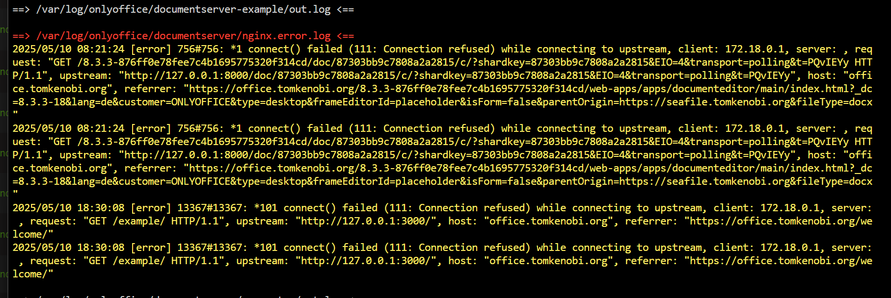

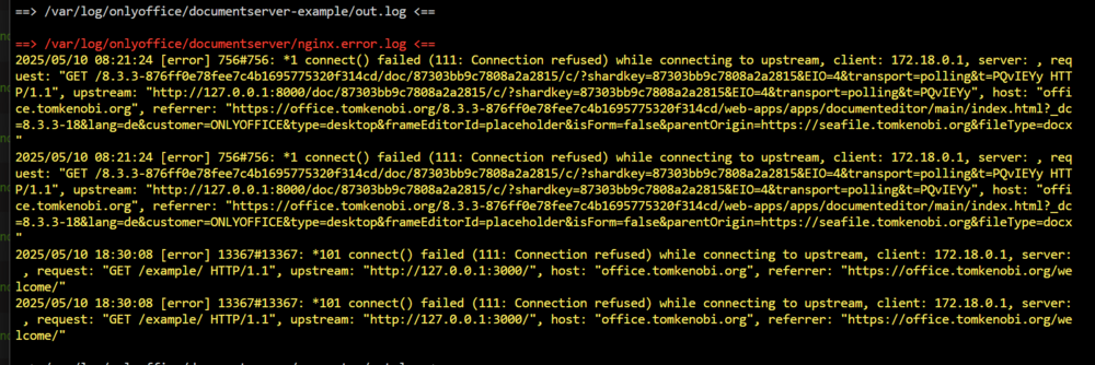

  8. Hi all! Just a quick screenshot from the OnlyOffice log, as I remember to have something similar. Se here: But everythings works. I can edit all types of files, they get locked in Seafile during this, I can all save them. Also on my phone. So this is probably not a big deal. At least for me as I do not understand this log. Maybe someone can help me out. But it works. Regarding reverse proxy I use Nginx Proxy Manager. So I can't say anything about Swag.

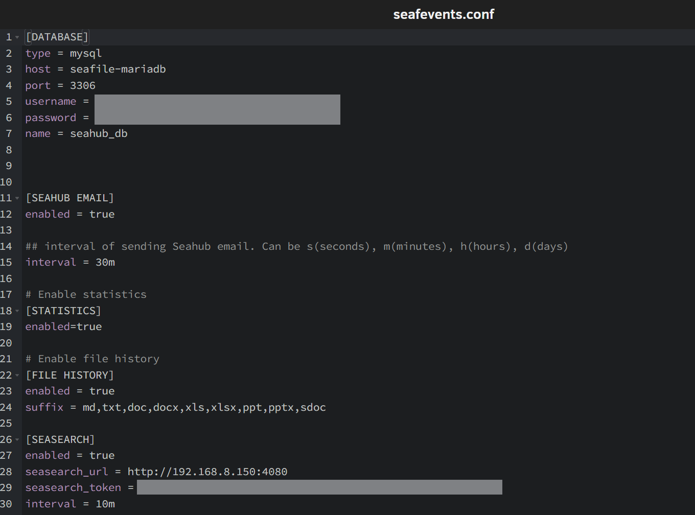

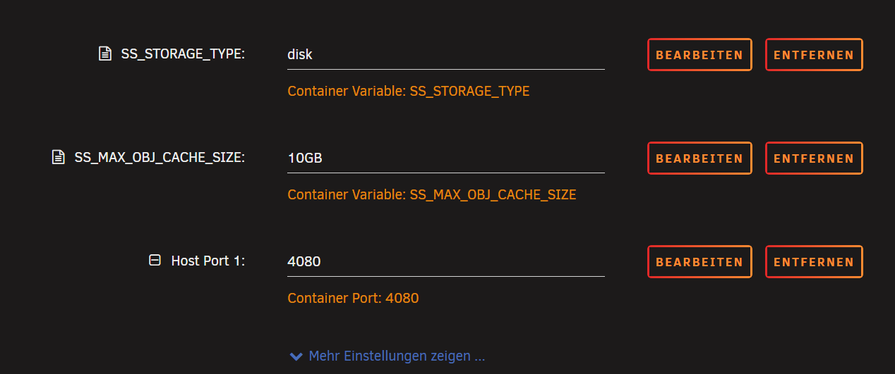

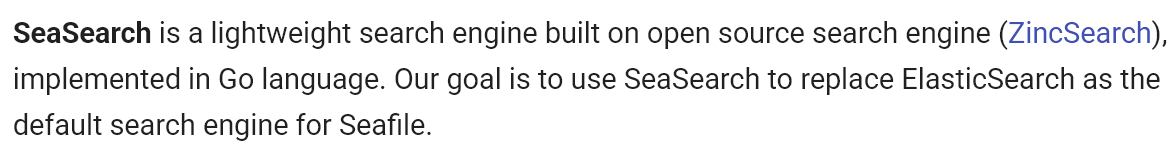

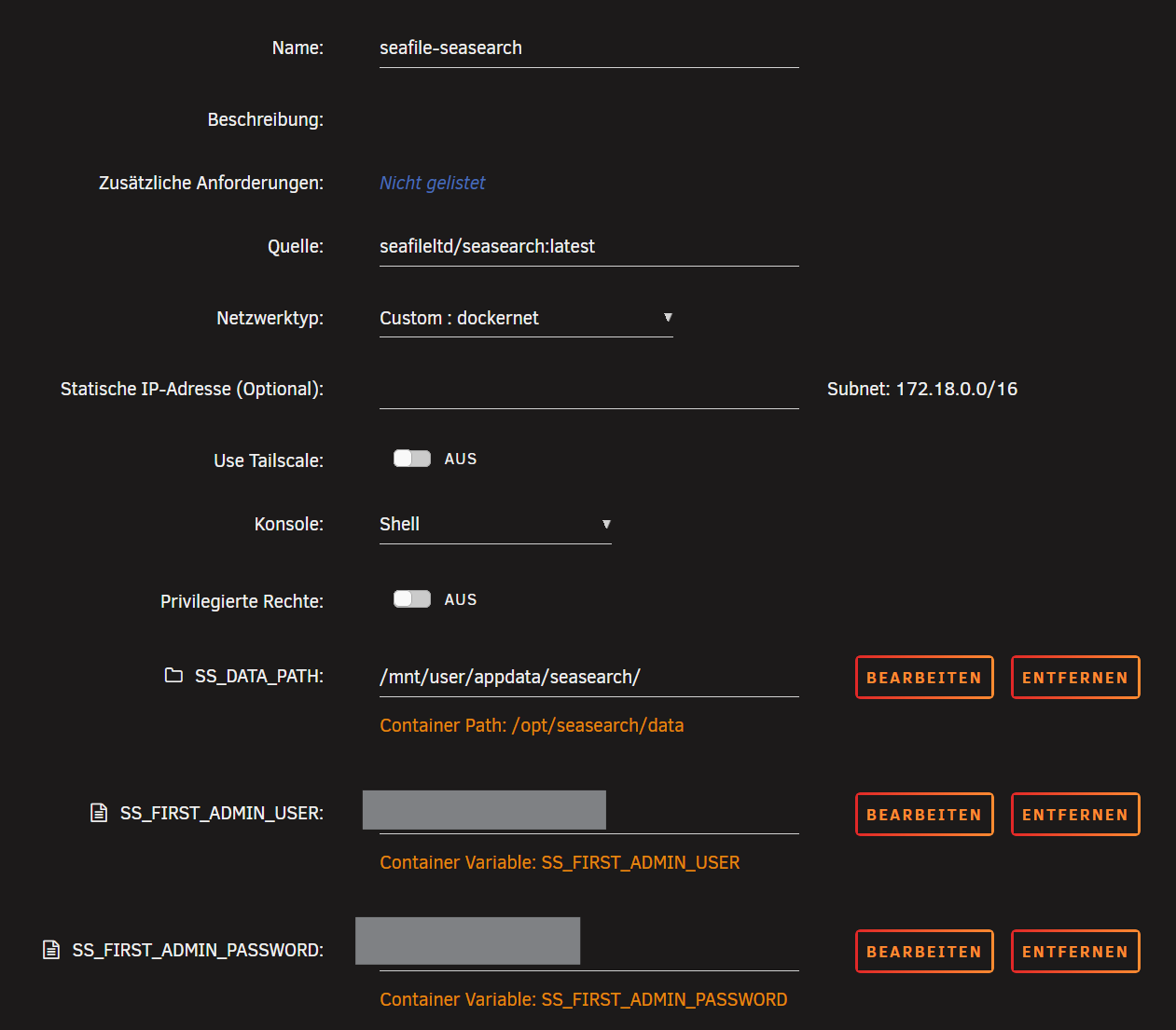

  10. Quick update: I somehow managed to get Seasearch up and running. I took a detailed look at the seasearch.yml file and manually added all the variables that seemed necessary into a completely new Docker template on Unraid. I have no idea which of the variables might be redundant. Maybe someone with a more trained eye could take a look and comment. Here are the entries I added to seafevents.conf: I wasn't entirely sure about the value for seasearch_url, so I just tried it this way. The first sign of success was that, unlike my previous attempts with Elasticsearch, the local folder actually started filling up with data. After about 10-15 minutes, I was able to see relevant search results in Seafile. However, it doesn’t seem like the contents of the files themselves are being indexed yet. I'll keep an eye on that. But for now, I consider this a success, even though it took me more than half a day to get it working. Best regards, Tom

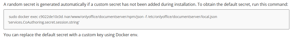

  12. Update – Thanks to the instructions on GitHub, I’ve now successfully integrated OnlyOffice as well. However, it only worked externally once I made the service accessible from outside. Apparently, there are ways to do it differently, but this seemed like the simpler method. Something went wrong during my first attempt, though I’m not sure what exactly. On the second try, I skipped this step: If I understand the OnlyOffice welcome page correctly, this command is only necessary if no secret key was set during deployment. Since I did set a 40-character JWT secret key (replacing the 'secret123'), I believe this approach should be fine. I’ll test it again when I’m back at my desk and see if I can figure it out, what went wrong on my first approach. I think I may have mixed something up when using the following command, and in the end, I entered the wrong key in the seahub_settings.py file. I'm a bit confused about what is meant by 'random secret', 'custom secret' and 'default secret'. To my understanding I set a 'custom secret' within the Unraid Docker template (and by doing this replacing a 'default secret'?). This 'custom secret' I wrote into the seahub_settings.py. As for Seafile Pro, I’ll definitely give it another shot. Instead of Elasticsearch – which, according to the Seafile developers, is going to be phased out – I’m planning to try Seasearch. Hopefully I can get that working, too. Full-text search within documents is a real advantage over simple file name search.

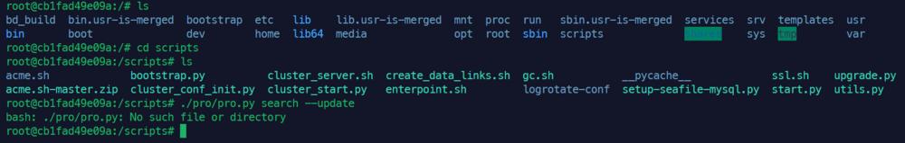

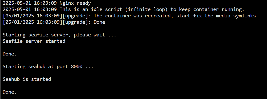

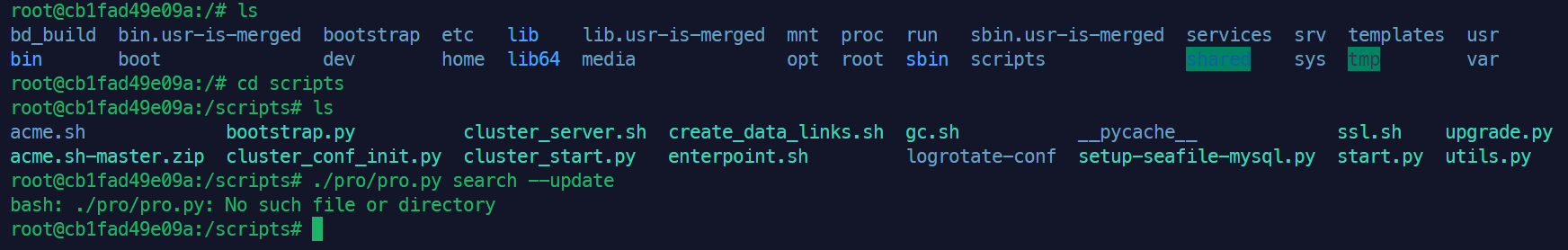

  13. I’ve now switched back to the Community Edition. I followed the guide by @dglb99, and the log shows the following: So it looks like everything worked I guess. Search is now functioning again within the libraries. Honestly, I don’t really need most of the features from the Pro version. Sure, full-text search would be a great feature, and I could probably make good use of fine-grained folder permissions as well — but that’s really just nitpicking at a high level.

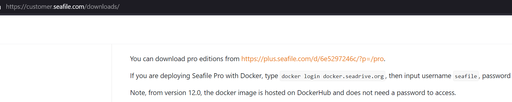

  14. Thanks for the clear summary! That explains exactly what I ran into — especially the part about the "Page Unavailable" error when using wrong credentials. I didn't realize it was tied to the memcached config. I just tested it myself using intentionally wrong login credentials — and you're absolutely right. It brings me back to the error page. I’ll give your suggestion a try. Also, something I noticed with the Pro version: search doesn't work at all out of the box. It seems you need to install either Elasticsearch or Seasearch. That looks a bit tricky to set up — at least for me. I've now installed memcached, and it works as expected — even when entering incorrect login credentials. Thanks a lot for your help @MowMdown! As you mentioned, changing the seahub_settings.py to use memcached > localhost didn’t work for me either. But I didn’t go any further trying to remove the entire block — since everything is working fine now with memcached running.

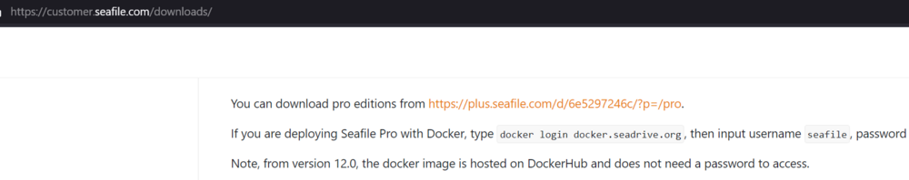

  15. Since I'm already on a roll, I decided to give Seafile Pro a try as well. I initially followed the guide by @dglb99, and while registering at customer.seafile.com, I found out that starting from version 12, the Docker images are available on Docker Hub and no login credentials are required anymore. I'll test it out right now — and if everything works, I’ll update this post shortly. I tested it. First, I used seafileltd/seafile-pro-mc:12.0.12 as the image source, and that version was installed as expected. On another attempt, I tried seafileltd/seafile-pro-mc:12.0-latest, which pulled version 12.0.11 instead. I’ve decided to stick with that for now. If I run into any issues, I’ll report back here. But it looks like I’ve finally reached my goal. I'm still in the process of organizing data from various sources into a clean folder structure, roughly separating archive folders from those I want to sync. The sync folders — which are located in a dedicated share on my Unraid server — will be synced to my PC using the Seafile Sync Client, each as its own library. Both main directories — archive and sync — will then be backed up regularly via rsync to a separate Synology DS. I believe this setup should be fairly solid. I’ll leave the encrypted data that Seafile stores in its own share as-is — basically treating it as an additional "backup".
