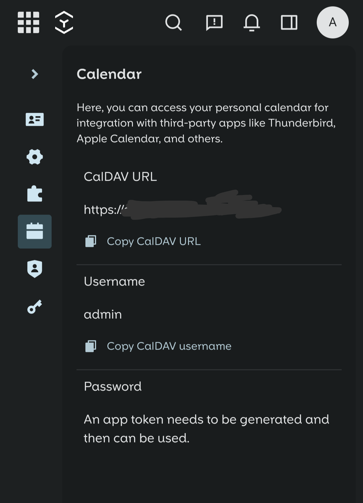

Added support for Radicale. New opencloud-radicale container in my GitHub templates folder. Also updated Opencloud template and installation script.
The script creates the radicale folder and also the config files.
https://github.com/Nemuritor01/Unraid-Templates
The opencloud container just needs the path to radicale proxy.yaml. So you can add it manually to an existing container.
Stop OpenCloud, edit template, add this path:
Name: Radicale Proxy Config File
Container Path: /etc/opencloud/proxy.yaml
Host Path: /mnt/user/appdata/opencloud/config/proxy.yaml
Access Mode: Read/Write
Edited by Nemu

29 minutes ago, Nemu said:
There is already pocket-ID V2, now. ;)
So far, I´ve tested it with desktop app, android, web. IOS will follow in the next days. So far. no issues.
Getting collabora to work was a pain in the a... but now it´s fine.
