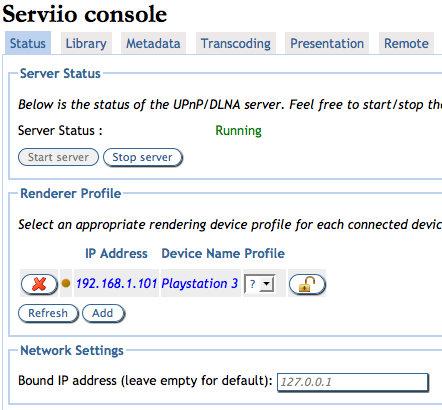

I rebooted the tower and still no luck.
It looks like ffmpeg is installed as I can see it in the directory (see pic).
Okay, I checked the Serviio logs and it appears it is adding my movies now. :)
I'll wait until it completes and we'll see what happens....

Hello, I am unable to see serviio installed on my Unraid box, from my PS3 (my only render device). I am able to connect to the serviio installation on my mac from my PS3 without any issues. Please assist me in making full use of serviio. Here are the steps i've taken thus far:
*used system properties to configure bound address
    # Setup Serviio specific properties
    JAVA_OPTS="-Dserviio.home=$SERVIIO_CONSOLE_HOME -Djava.net.preferIPv4Stack=true -Dserviio.boundAddr=192.168.1.108 -Dserviio.home=/boot/config/plugins/serviio/serviio-1.1"
*Forwarded ports 8895 TCP and 1900 UDP through router firewall by setting internal & external port forwarding to 192.168.1.108 (serviio host machine's ip). Also temporarily turned off the router firewall :shock: to make sure that wasn't the issue.
*Using the FAQ links I setup multicast routes, but im not too familiar with this so I just used the examples given in this forum then deleted the entries after I still couldn't connect to serviio.
*After trying the above and more I am still no closer to seeing serviio from the PS3. Below/Attached are the relevant logs:

@kingJahfy
Does the serviio plugin say it is installed and running? and does the serviio webui say serviio is running?
Thanks for the quick response. Serviio logs indicate its running and the webUI also says serviio is running:
2013-02-12 12:37:41,005 DEBUG [PlaylistMaintainerThread] Item '/mnt/user/media/All Video/tutorial/lynda-joomla/supportFiles/ipad/EN190_09_03.mp4' cannot be resolved to an entity in the Serviio library, will try again later
2013-02-12 12:37:50,711 DEBUG [FeedUpdaterThread] Checking for new and expired online resources
2013-02-12 12:37:50,712 DEBUG [OnlineRepositoryDAOImpl] Reading all OnlineRepositories
2013-02-12 12:38:50,722 DEBUG [FeedUpdaterThread] Checking for new and expired online resources
2013-02-12 12:38:50,722 DEBUG [OnlineRepositoryDAOImpl] Reading all OnlineRepositories
2013-02-12 12:39:01,573 DEBUG [DiscoveryAdvertisementNotifier] Found 1 network interfaces to advertise on
2013-02-12 12:39:01,573 DEBUG [DiscoveryAdvertisementNotifier] Multicasting SSDP alive using interface eth0 (eth0) and address 192.168.1.108, timeout = 0
2013-02-12 12:39:01,574 DEBUG [DiscoveryAdvertisementNotifier] Sending 6 'alive' messages describing device 846be3a6-e7a8-3d4a-b261-e1933d0510a0
2013-02-12 12:39:03,562 DEBUG [DiscoveryAdvertisementNotifier] Will advertise again in 00:03:47 (advertisement duration is 1800 sec.)
2013-02-12 12:39:50,733 DEBUG [FeedUpdaterThread] Checking for new and expired online resources
2013-02-12 12:39:50,733 DEBUG [OnlineRepositoryDAOImpl] Reading all OnlineRepositories
2013-02-12 12:40:50,743 DEBUG [FeedUpdaterThread] Checking for new and expired online resources
2013-02-12 12:40:50,744 DEBUG [OnlineRepositoryDAOImpl] Reading all OnlineRepositories
Changed log4j level in serviio config to debug to get more fine grained info. Attached webUI screenshot
Update: Uninstalling and reinstalling the updated version resolved my issues
