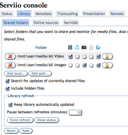

Changed log4j level in serviio config to debug to get more fine grained info. Attached webUI screenshot
What do you have under the library tab in the webui?
Hey mayhem2408,
I've attached a screen shot of my library-shared folder page, I have no online sources. Whats your router firewall/port forwarding setup? did you setup multicast on your unraid box? thanks again.
