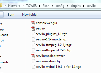

Okay, so I found my logs and it appears (like a lot of other people here) that ffmpeg is not installed. I am running the cache version of the plugin. So I tried to install ffmpeg by telnet'ing into the tower and typing
installpkg /boot/config/plugins/serviio/serviio-ffmpeg-1.2-1jr.tgz
Doing that gives me this:
Tower login: root
Linux 3.0.35-unRAID.
root@Tower:~# installpkg /boot/config/plugins/serviio/serviio-ffmpeg-1.2-1jr.tgz
Verifying package serviio-ffmpeg-1.2-1jr.tgz.
Installing package serviio-ffmpeg-1.2-1jr.tgz:
PACKAGE DESCRIPTION:
WARNING:  Package has not been created with 'makepkg'
Package serviio-ffmpeg-1.2-1jr.tgz installed.
... yet it does not appear to be installed anywhere. I've tried rebooting the tower with nothing. I've seen people here referencing installing ffmpeg.sh, but I don't have that. I've also tried to append the code that was suggested by DigitalDrifta but that didn't work.
Any help would be appreciated. :)

The ffmpeg tgz i created is not a slakeware package , just a compressed bunch of files.
My setup script unpacks it using the tar app.

Well I tried the newest version and ffmpeg is still not installing. My log repeats this over and over:
2013-02-05 11:21:58,918 WARN  [ProcessExecutor] Cannot retrieve results, output reader is null
2013-02-05 11:21:58,919 ERROR [ProcessExecutor] Fatal error in process starting: Cannot run program "ffmpeg": error=2, No such file or directory
DigitalDrifta posted this:
You need to go to /boot/config/plugins/serviio/ffmpeg and run ffsetup.sh
So I went to that location but there is no ffsetup.sh to run.
Thanks in advance for any help/guidance. :)
