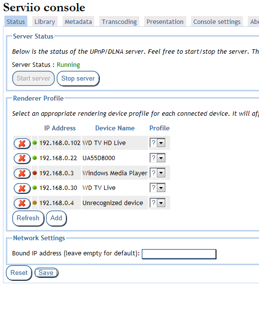

Since updating the plugin to 1.1 i get the following error while trying to open the web gui:
Internal Server Error
Can't find bundle for base name www.i18n.messages, locale en_US
You can get technical details here.
Please continue your visit at our home page.
Tried clearing browser cache, no change.
It's just the gui that stopped working, server is fine and can be configured with the console app on my win. pc.
I'll contact the webGUI developer about this one. I have never seen that fault and can't make sence of it.
Having updated to the latest version my problem is solved. Don't know what happened but it solved itself apparently :)
