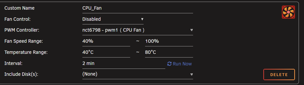

Do we need to set also Fan for CPU ?
cant we use CPU Fan by CPU Temperature?

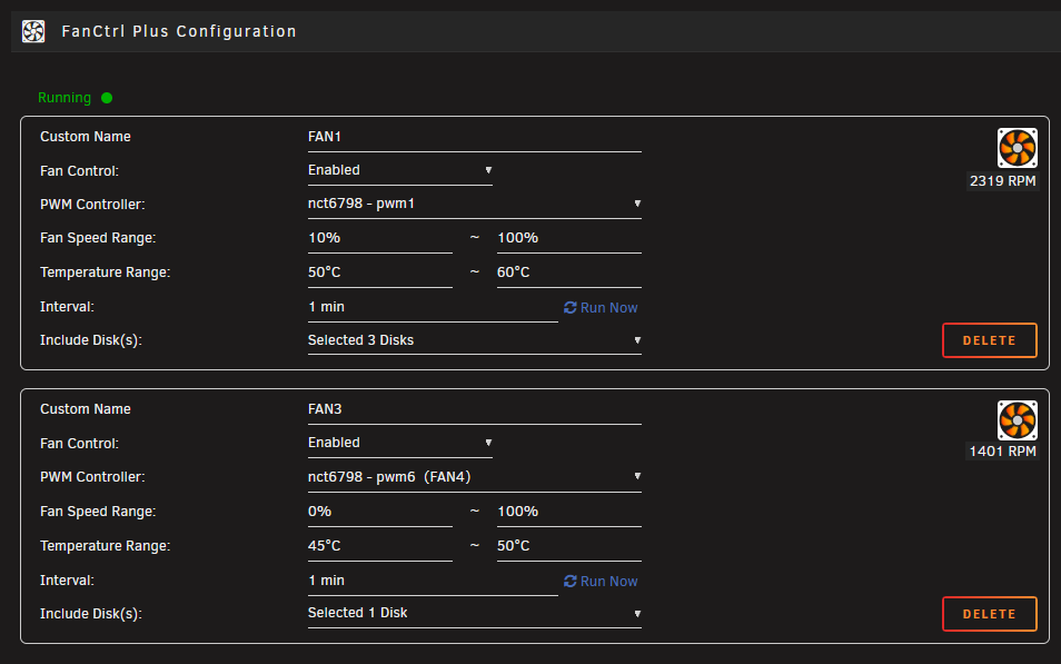

Hello my friend, I'm back to say that it's working perfectly in my Supermicro 12-bay case, since the first version was released. Congratulations!
I have another contribution for your project: add the RPM to adjust the minimum speed in RPM by percentage. Add the RPM on the configuration screen, see example below
The next version will support CPU temperature, and itโ€™s expected to be released in a few days.
However, I recommend letting the BIOS handle the CPU fan for safety and reliability.
If you choose to control CPU fan using FanCtrl Plus, please make sure to test carefully and take responsibility for the configuration.
Thanks for the suggestion!
Right now, you can already see real-time RPM in the Dashboard (or syslog) โ€” just open it in another tab while adjusting your settings.
In the next version, the fan configuration will include a chart popup showing a temperature curve, and Iโ€™m planning to add real-time temperature and RPM display there too. Stay tuned!
So i can leave it like this (Disabled) to allow to BIOS to control it ?
You can leave it disabled, but if it was enabled before, the BIOS often wonโ€™t take back control of the CPU fan until you reboot. If you donโ€™t plan to control the CPU fan anymore, Iโ€™d suggest deleting it instead of just disabling โ€” to avoid accidental re-enabling. Just make sure to reboot after that.
OK got it, Thanks.

Thanks for your quick reply!
Yes, I understand that you can open another tab, but I want to avoid having everything on the same screen.
Also, since you saw the new update, 7.2.0, coming out, the screens will be responsive on mobile devices. It would be better to view and align them.
Here's the link to the plugin update.
Iโ€™m aware that Unraid 7.2.0 will bring a major UI overhaul. Because of that, Iโ€™ve decided to hold off on any new UI features until after the new design is finalized โ€” otherwise itโ€™s very likely things will break or look wrong.
Right now, Iโ€™m focusing on finalizing the current update features. If the plugin doesnโ€™t suit your needs in its current form, I understand โ€” FanCtrl Plus might not be the right fit for everyone.
Iโ€™m developing this plugin in my spare time as a beginner still learning along the way, so I have to prioritize stability and maintainability over adding every request.
