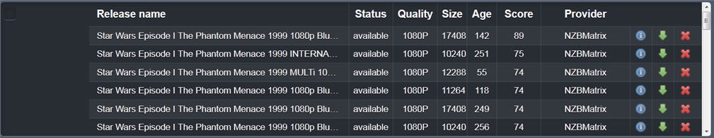

I'm flummoxed.  I now have couchpotato v2 running.  I can find movies, and it will show me results.  I had to force it to refresh the page with shift-refresh, and i now see the movies I've chosen, but there is no cover art, with Firefox.  in IE, It shows covers.
However, in both programs, it shows a list of available downloads for each movie, and a big, green, down arrow.  clicking the arrow does nothing.  i expected it to force the download of the file, but nothing ever happens.  SAB is not getting any new nzb's.  i have nzb.su and nzbmatrix premium accounts, and both appear to be setup properly in CP, but I never get any movies to begin downloading?
I've checked the CP support site and it's pretty desolate, and I didn't want to register just to ask about what is likely my dumb mistake.
Any ideas why nothing is going to SAB?

Couchpotato V2 is finding the movies I choose but it is not sending them to SABnzbd. I'm getting this in the log:
[ato.core.plugins.searcher] Tried to download, but none of the downloaders are enabled
anyone know why this is. I'm certain I've set all the settings up correctly.
*** I think I had to set my ip to 0.0.0.0 instead of the ip of my router !! *** it seems fixed now :)
Go to Settings - Downloaders and make sure there is a check next to Sabnzbd and the settings are all filled out
Open your settings.conf and make sure its set to enabled there, its possible the settings.conf isn't being updated.
Thanks man appreciate your help I think I got it working as the movies are being snatched to sabnzbd which im frikkin pleased to see. One thing though, It seems to snatch 2 or 3 versions of the same movie? Do you know why this would be?
