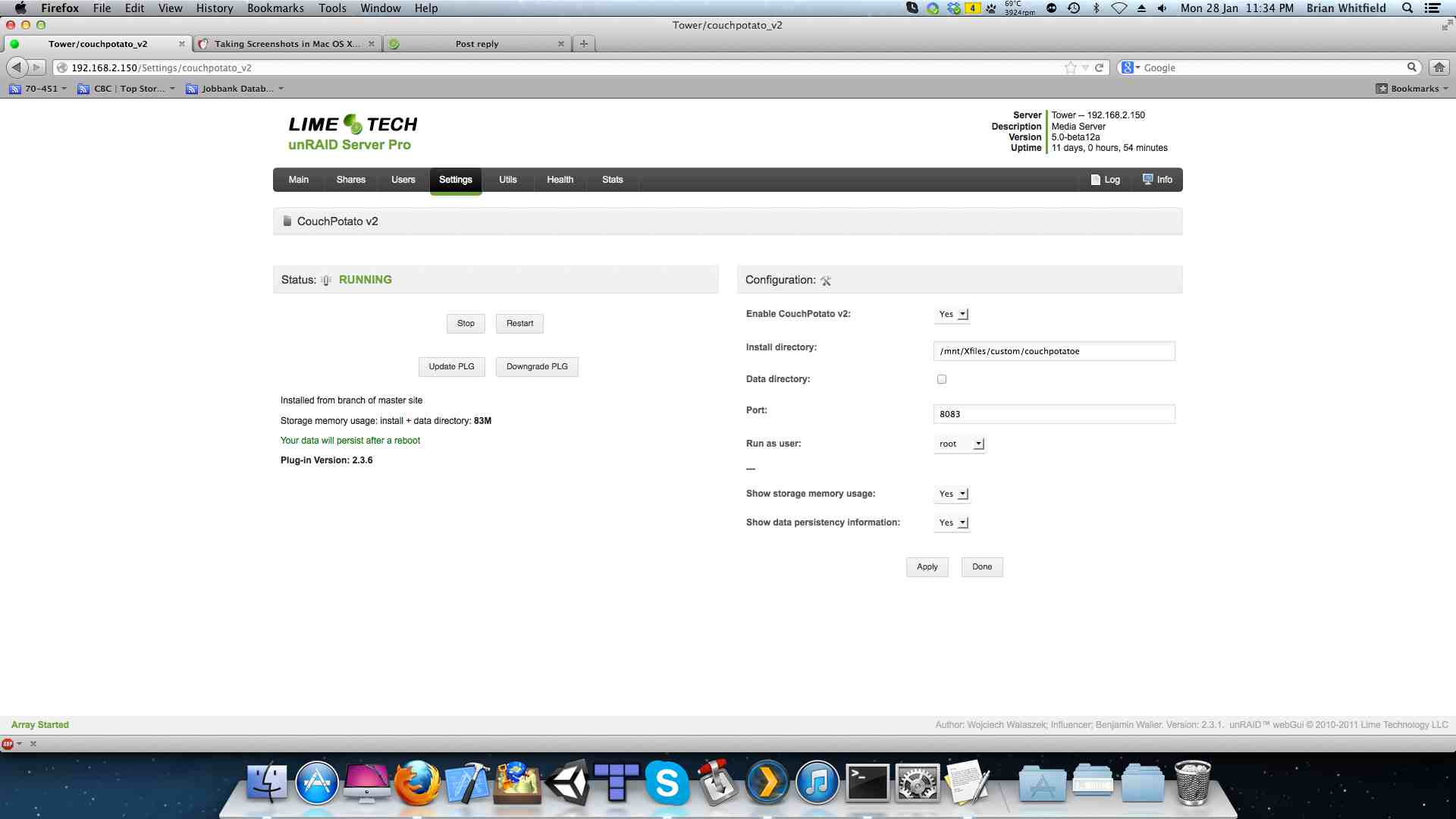

For some reason the plugin says Couch Potatoe is running, but it is not. When I run the command ps ux through a telnet session, it is not shown. I even tried starting CP manually using this:
sudo -u root python /mnt/Xfiles/custom/couchpotatoe/CouchPotato.py --daemon --config_file /boot/config/plugins/couchpotato_v2/settings.conf --pid_file /var/run/couchpotato_v2/couchpotato_v2.pid
The plugin shows all my settings have been saved (using port 8083) and that my data persists, but I cannot get it to start. No error when I run the above command through telnet. Any ideas?
Attached is a screenshot of the CP Plugin settings. Any help is greatly appreciated!
-taros
-taros
Didn't you see any of the rest of the thread? this version has not been supported for months. Use Influencers version in the other thread.
This version is abandoned. If you need support go to the thread located in my signature. I, as well as other users, follow that thread and will help where we can.
