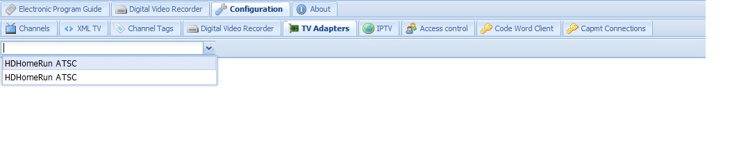

Quick question, the precompiled TVheadend plugin with the HDHomeRun tuners, was that for the ATSC one or the DVB version?
I had a few seconds before work to get the plugin installed with a working network card and the TV adapter tab only had the ATSC version listed.

It should work for DVB also. The only catch is that you may need to make some changes to the dvbhdhomerun configuration file. See here http://sourceforge.net/apps/trac/dvbhdhomerun/wiki/FAQ.

Might be a dumb question but where is the dvbhdhomerun config file?
/etc has no hdhomerun stuff, only the /sys folder.
I'm assuming I also don't need to load the modules as the plugin should do that right?

Hey, yes it should be placed in /etc. I'm not sure if the plugin loads the modules or not. I load them from the go script, see my instructions a few pages back. Just check using lsmod to see if they are loaded. On my system, I see this:

All I see when I get to the webinterface is this selection from the TV adapter section as per the attached picture.
Have no ability to select location in Australia but I don't know if that is to do with it.
There is nothing in the /etc folder I tried a find command and it only showed hdhomerun stuff in the /sys folder.

Yeah the lsmod all looks good. I would just try to create the config file in etc and reload the modules and see if it then changes to DVB. I know on my ubuntu system all that was necessary was to edit that file to change from ATSC to DVB.
