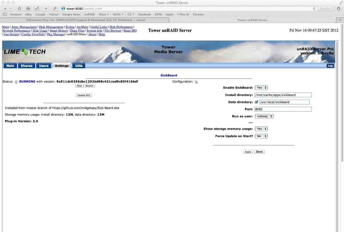

Having an issue I'm hoping someone can help me with, I have sickbeard configured to run as "Nobody" and the data directory is /mnt/cache/apps/sickbeard
It survives if I take the array offline and put it back on line - however if i restart the unraid server it loses all its config saying it cant find;
Unable to find '/mnt/cache/apps/sickbeard/config.ini' , all settings will be default!
Can anyone help with this? As mentioned its only lost on reboot.
Thanks :D
I'm not sure about the cache drive, but it could be, that it tries to move your config to the array.
try to use /mnt/cache/.apps/sickbeard as data directory. folders starting with a dot will be ignored by the mover script.

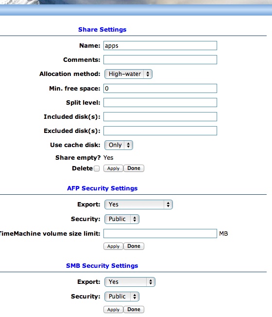

Folders starting with a . are ignored, but you should set the apps share to cache only, that way the mover ignores it without the need to make the folder hidden(the . makes it hidden in linux).
I would venture to guess that the directory is being created before unraid mounts the cache drive, which would mount it in ram(causing the loss on reboot).
Can you tell me what it says on the plug-in gui? It should say whether or not your data dir will persist after reboot.
Please keep the data directories for these plug-ins separate to avoid any permission/access issues with the plugins. I suggest having a single top level directory named apps, and sub-directories for each app.

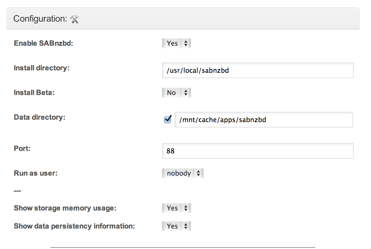

I am having an issue with the SABNzbd plugin.
I have followed all the instructions but I am having a permissions issue when I try to start the plugin.
The error log is below:
Exception in thread HTTPServer Thread-9:
  File "/usr/lib/python2.6/threading.py", line 532, in __bootstrap_inner
    self.run()
  File "/usr/lib/python2.6/threading.py", line 484, in run
    self.__target(*self.__args, **self.__kwargs)
  File "/usr/local/sabnzbd/cherrypy/process/servers.py", line 75, in _start_http_thread
    self.httpserver.start()
  File "/usr/local/sabnzbd/cherrypy/wsgiserver/__init__.py", line 1644, in start
    raise socket.error, msg
error: [Errno 13] Permission denied
This is an unraid system that was upgraded from 4.7 and I did run the upgrade script to reset permissions.  I also made sure the permissions on both the SAB app directory were reset and also the app directory on mnt/cache.
Any ideas?
