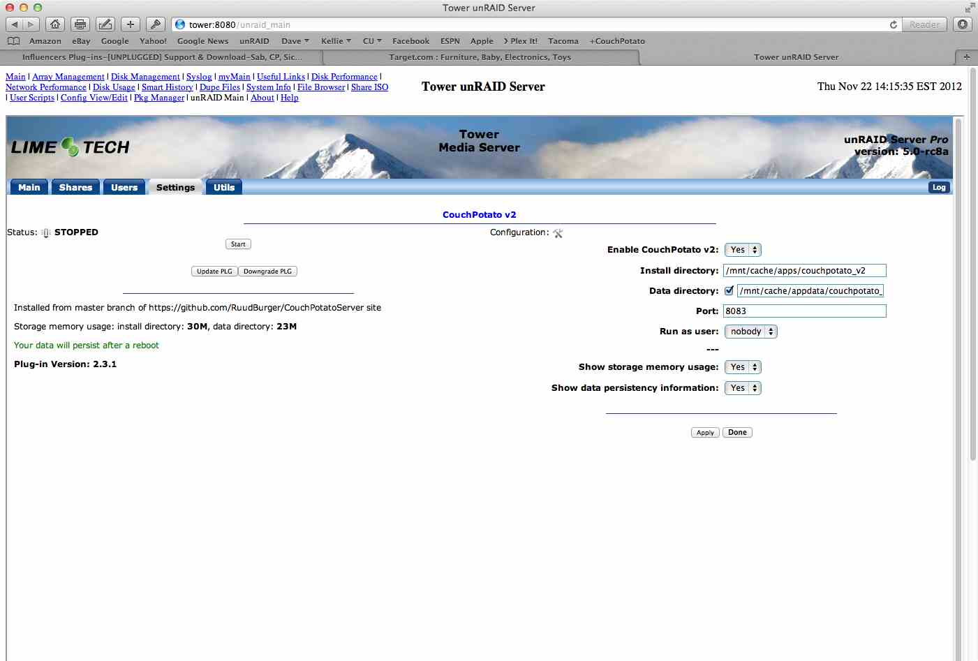

Everything should be fine, Influencer help set this up for me.  I restarted the server and now it won't start.
  • Replies 2.6k
  • Views 563.9k
yes, those settings look ok.
check your syslog and the couchpotato log for errors.
you can also try to start couchpotato from telnet and see, if you get an error.
/etc/rc.d/rc.couchpotato_v2 start
is there a log file in your couchpotato data dir? the syslog looked ok.
i'd guess there could be a permissions problem. go into your app dir and your appdata dir and type "ls -la". the user should be nobody and the group should be users
there obviously seems to be trouble about a .AppleDouble folder.
check your install dir and your data dir and delete the .appledouble folders, if there are any.
these folders will be automatically created, if you go into a folder over an afp-share.
you could work around this, by connecting the cache drive via smb to your mac.
