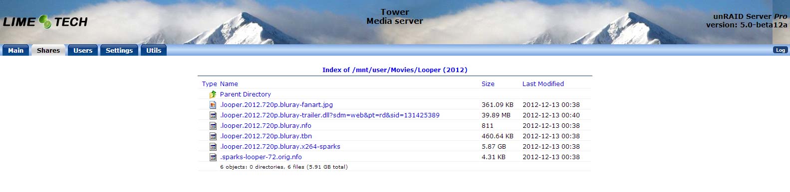

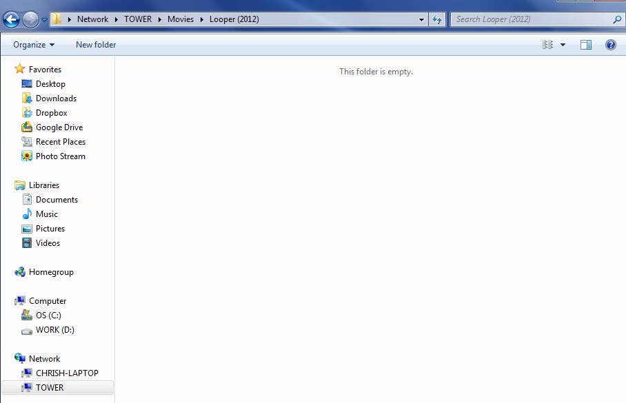

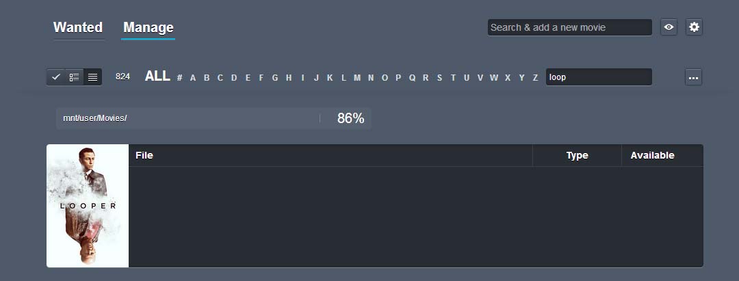

Hi, hoping someone can help. I have been running Sickbeard & Sabnzbd on my unraid for a while now and everything has been working fine. I recently installed Couchpotato though and I can't seem to get it working.
Everything appears to be correct in the settings and it snatches movies and sends them to Sabnzbd fine.
These download correctly on Sabnzbd.
A directory is created under /mnt/user/Movies correctly.
But when I view the new directory in Windows Explorer it shows no files.
The movie is not adding itself to my XBMC either.
But if I view the folder via //tower in my browser and going to shares and finding the folder then I can see all the movie files there.
Does anyone know why I wouldn't be seeing these files in windows explorer or why xbmc can't see them?

Thanks. I have removed the duplicates, but still having the same issue. Everything downloads ok and is on my server, but I am unable to access the files from windows explorer or xbmc.
Attached are some screenshots to hopefully explain. I thought this might be a permissions issue, but I have run the permissions script on unraid and tested and I am still getting the same issue.
Your files start with a dot. those files are hidden on a linux system.
if you remove the starting dot, the files should be visible.
check your couchpotato renamer settings. i'd guess, there is a dot in your naming template.
thanks, missed that full stop that snuck in there
