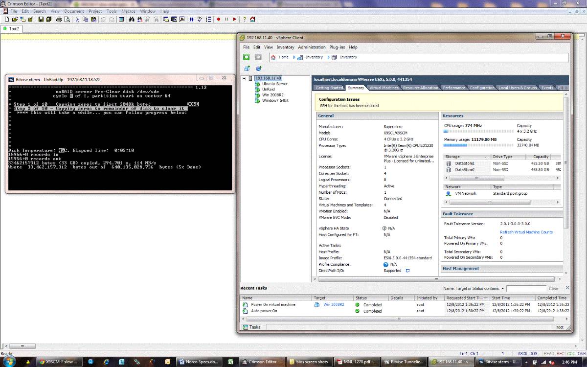

As far as I know the amount of RAM you set up your VM with is not an impact on the write speeds.  My ESXi UnRaid VM is set up with 4GB of Ram.  And again, I can't explain it.  Last week, this setup of 4GB for the VM with 32GB in the system gave me less than 1MB write speeds with Unraid-Rc8a.    However today, after testing 1 Stick of Memory at a time, I am now getting good write speeds.
I'll be happy to post screen shots of anything if it helps.    I am still using Bios Version 2.0a.
