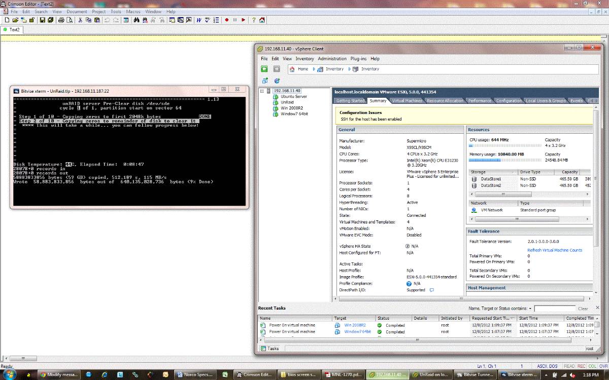

Also, if your not aware of it, this board does required unbuffered RAM.  I have 32GB total 4x8GB ECC DDR3 UDIMM Kingston Memory.  In the last hour here, I first booted up with only 8GB memory in 1 slot.    I then started a preclear on a spare smaller 640GB WD drive.  Write speeds are 100+MB/S.
I than shutdown and added a 2nd stick for 16GB Memory.  Again, running preclear, received 100+MB/S
This is also running unraid as a VM with ESXI and pass through.  I also took some screen shots as well if anyone needs to see them.
Also, make sure you are installing your memory in the proper order of:
DIMM2A , DIMM2B, DIMM1A, and DIMM1B
I'm about to add a 3rd stick of memory back in to see what happens.
EDIT:  With 24GB of Ram, I am still getting could write speeds.
