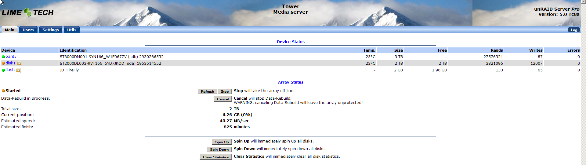

Edit:  Parity sync (w/ 3TB parity drive and 2TB data drive) is running at ~ 90 MB/s.  Parity check (non-correcting) is running at ~ 110 MB/s.
The data disk rebuild is rebuilding the data disk at ~ 40 to 50 MB/s.
The parity and data disks are both plugged into the 6 Gbps (on-board) SATA ports of the X9SCM-F (Intel Cougar Point 6-port SATA AHCI Controller, (2) 6 Gbps & (4) 3 Gbps SATA ports).  The parity drive is rated at 6 Gbps and data drive is rated at 3 Gbps, so it seems logical that the data disk rebuild would have approximately 1/2 the "parity sync" and "parity check" speeds, correct?
It should be about the same. Compare the completion times.

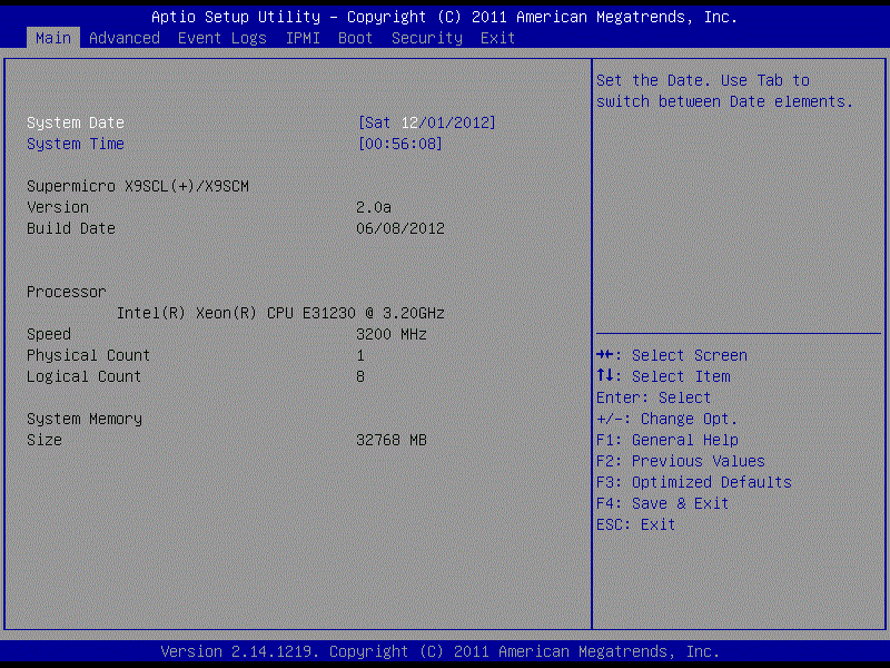

I can't find the bios version in the Unraid System Info.  Which 'button' would you that be under?
But I do know that I am on bios version 2.0a.  And I believe Moose is using the latest 2.0b.  Thus, it could be something in the bios settings, which was why I uploaded a bunch of screen shots of the bios settings.
But here's a pic of my Bios Version.
I can look into changing it to 1.1a as well.  I don't remember why I upgraded it.
Edit:  There website only lists the latest 2.0b bios.  I emailed them to try and get the older 1.1a version, but I a quick google search found them here: http://hardforum.com/showthread.php?t=1666761
But I do know that I am on bios version 2.0a.  And I believe Moose is using the latest 2.0b.  Thus, it could be something in the bios settings, which was I uploaded a bunch of screen shots.
Think I should downgrade the bios?
When I initially had the slow write problem, I downgraded from v2.0a to v1.1a => problem still existed.  I then went back to v2.0a and then to v2.0b (current) => problem still exists, so I don't think switching BIOS makes a difference.
If you do downgrade BIOS (at least to v1.1a), you need to follow a specific sequence to avoid other issues.  Here is where I discuss going from v2.0a to v1.1a BIOS:  http://lime-technology.com/forum/index.php?topic=22675.msg202154#msg202154
You can find your BIOS version in unRAID in the "system log", "Utils" -> "System Log", then scroll through the log sequence to locate.
I confirmed in the system bios that I am at bios Version 2.0a.  But now you scared me off of downgrading the Bios to 1.1a in fear's of bricking the MB, and that it didn't help you either.
