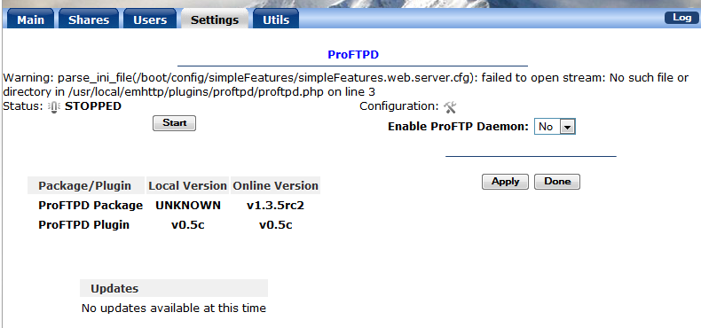

I just installed your plugin for testing purposes, but plan on opening it up to the world later.  First I need to get it working.  It installs fine, but doesn't seem to start (unless there is a bug on the display of the status screen.  Because when I point filezilla to 192.168.1.106 and login with newly created ftpuser, I get
Status:	Connecting to 192.168.1.106:21...
Status:	Connection attempt failed with "ECONNREFUSED - Connection refused by server".
Error:	Could not connect to server
It doesn't matter if I have a password or not for the ftpuser.
Here is what the ProFTPd status screen looks like after I start the service and enable the FTP daemon:
ProFTPD
Status: STOPPED
Package/Plugin 	Local Version 	Online Version
ProFTPD Package 	UNKNOWN 	v1.3.5rc2
ProFTPD Plugin 	v0.5c 	v0.5c
Syslog reports the following from when I start proftpd, but there is no indication that filezilla tried to login:
May 27 06:50:59 Server1 sudo:     root : TTY=unknown ; PWD=/ ; USER=root ; COMMAND=/usr/local/sbin/proftpd -c /etc/proftpd.conf
Install section from syslog:
May 26 22:44:26 Server1 logger: installing plugin: proftpd
May 26 22:44:26 Server1 logger:  file /tmp/plugin-prepare: successfully wrote INLINE file contents

The local version of the proftpd package should be the same as online. The unknown indicates something went wrong when downloading the package. Please click on update package. There should be a button under updates.
Please make sure you have Enable ProFTP Daemon on the right side set to Yes. Then please try to reboot your server. If it it still doesn't show the same version as online please check /boot/config/plugins/proftpd/ if there are proftpd-1.3.5rc2.tgz and proftpd-1.3.5rc-sql.tgz files and what their size is, then post again.
To start proftpd from commandline please use the following command and post the output if it doesn't work:
/etc/rc.d/rc.proftpd start
The plugin needs to show RUNNING as status. Only then we'll be able to check if the user/s are setup correctly.
Rebooting the server gives us the same result.  Still unknown.

That didn't help, but I guess I should try and eliminate the other things could interfere.  Following dgaschk disable addons process, I went to a stock go file and got rid of the plugins and extra directories.
http://lime-technology.com/forum/index.php?action=profile;u=12399
I rebooted and reinstalled.  But still get Unknown, see attached screenshot.  Looks like I haven't cleaned out simplefeatures completely either.
The error saying simplefeatures is caused by my plugin. It checks for the simplefeatures webserver config to use the webserver for the config editor. As you have removed simplefeatures it doesn't find the file. Of course this has to be rewritten in a way that it throws no error when nothing is found.
Now back to the unknown problem. Please check if you have the file /etc/rc.d/rc.proftpd
Then in shell call: /etc/rc.d/rc.proftpd getver app local
This is what is called by the web page to retrieve the local app version. If you don't have
this file or it fails we know a little bit more where the problem is.
