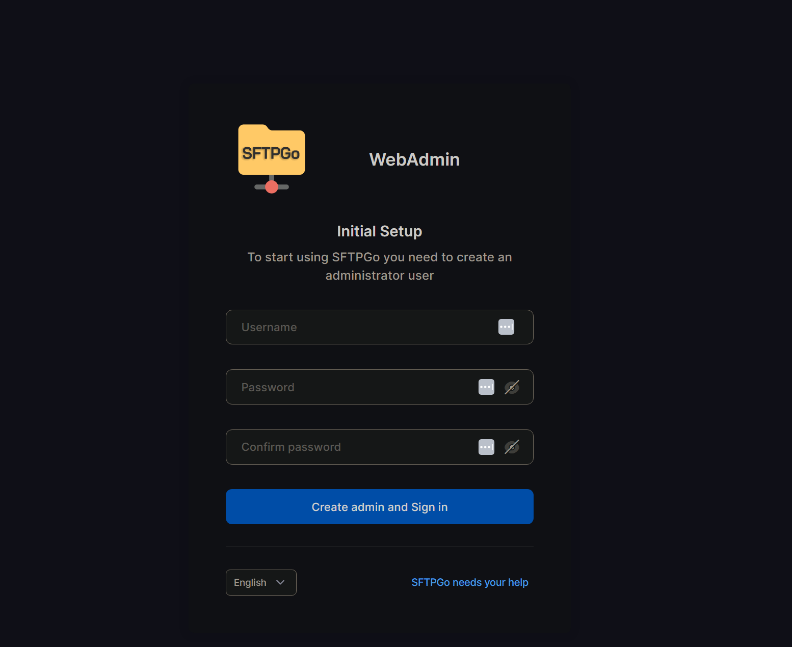

I recommend the SFTPGo docker container. It can also do plain FTP if that is what you want.
I've tried that one and I can't ever get passed the login screen. It's never asked me to set an account up and can't find the user/password anywhere to set it up. I've tried everything obvious.

You need to visit the admin webui http://192.168.2.212:2221/web/admin/ to create the admin user. Replace the IP with your unraid IP if  running in bridge mode.
So what's the password then?
This has been the issue from the beginning.
This is what I was talking about.
Ah, my bad. Change the port to 8080 and you should get to this page:
Just tested it on a fresh container, the URL is then: http://192.168.2.237:8080/web/admin/setup

If you're running it on bridge you probably have another container using post 8080. Change the network type to br0 and set an ipadress f.eks 192.168.1.225 or something (just temporarily so you can get to the setup page), then try again. When you have a user set up you can change it back to bridge if you want.
In theory it should also work if you go to http://192.168.1.140:2221/web/admin/setup

i see.. if you're remote on tailscale you also probably have to enable host access to custom networks in Settings->Docker. Or try when you're home.
Nope. Still didn't work.
This is frustrating.
EDIT:
So... I kinda went the long way around.
I tried installing it on a fresh Unraid server. Brand new install. I was able to setup an admin on that one. Afterwards, I then copied the sftpgo appdata file onto a network drive.
I then copied that appdata folder over to the one that I was trying to work.
Now it works? I haven't messed around with it much but at least I got into the "View and managed users" section. I still have no clue to what I'm doing on here though.

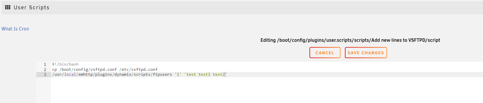

@Binary100100
You could make a vsftpd.conf file in the /boot/config folder with your correct settings. Change the chmod to 644 just in case.
chmod 644 /boot/config/vsftpd.conf
Start the plugin "User Scripts" and make a new script.
Add the following lines.
#!/bin/bash
cp /boot/config/vsftpd.conf /etc/vsftpd.conf
/usr/local/emhttp/plugins/dynamix/scripts/ftpusers '1' 'test test1 test2'
This will copy your correct config file from /boot/config/vsftpd.conf to /etc/vsftpd.conf
Last line is to automatic Enable the FTP-Server on startup. Remember to add the users you've granted access for in the end of the line.
The reason why I use the "User Scripts" plugin, is because it's easier to change the users you want to grant access to.
13 hours ago, j44rs4 said:
@Binary100100
#!/bin/bash
Okay. Simple enough. I already had user scripts setup to automatically fire up my FTP server. The issue was that the vsftpd settings wouldn't stick.
Will give this a try.
Thanks!
