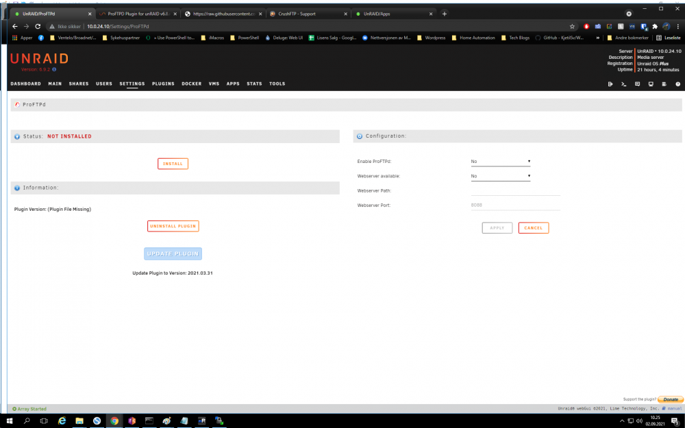

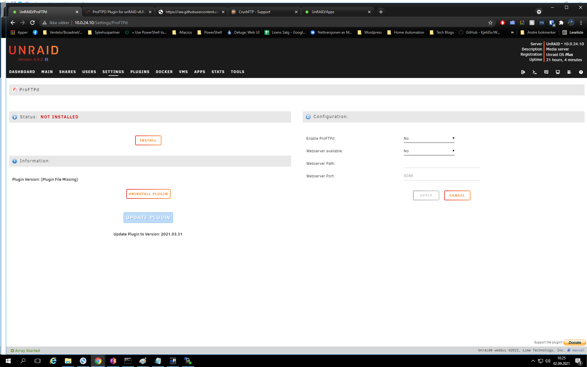

I get NOT INSTALLED even if i hit install, and uninstall don't do anything either
I think I had a similar issue in the past. If I recall properly... I manually removed the plugin and it's configuration file from my flash drive. I made sure to get everything related to the plugin and old copies in the plugins-old-versions folder and the plugins-removed folder. Then I rebooted unRaid and reinstalled the plugin from community applications .
@Flemming
The "Plugin file missing" under Information indicates a failed uninstallation. On why this happened, I have no idea. To get back to a clean state I would the recommend the manual removal and reinstallation described by @kricker.
If you have the time to experiment, what happens if you click "update plugin"?
It was under failed plugins.
I got it working by deleting, rebooting and reinstalling :)

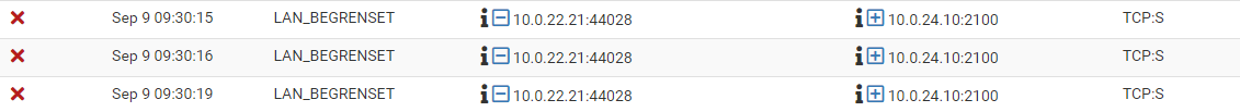

Now I can access my FTP with WinCSP, but not with my Reolink IP-cameras 🙄 Even with same settings
Looks like this is a common problem with Reolink/ProFTPd
Edited by Flemming
On 9/3/2021 at 3:12 PM, SlrG said:
@Flemming
Are there any error messages in the syslog when trying to connect?
After may hours of troubleshooting I found out that the problem is in my firewall, between the two VLAN's/networks.
I have now allowed traffic between them and it works.
In the future I want to limit my ports, do you have any information about what ports are being in use in Active and/or Passive mode?
