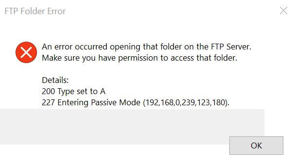

First off thanks for everything you have done for this plugin, I am pretty much a newbie to this stuff and your support is greatly appreciated.
I successfully set up my ftp server following this tutorial (I did change the port from 21 to something less obvious)
The server works perfectly on my local network, however, as soon as I try to access it from outside the local network, I get the error attached. I'm looked up the error and most issues seem to stem from a firewall or other things I don't understand. Do you know what could be causing this and if there is an easy fix?
@DrRooo
Have you setup the MasqueradeAddress and Passive ports in your proftp.conf file?
# using a DNS name
MasqueradeAddress xxxxxx.xxxxx.xxx
# NAT ports should be safe...
PassivePorts ##### #####
Where xxxxxx.xxxxx.xxx is your DNS name (which you can use DuckDNS to get one if you don't already have a static IP or DNS name)
and ##### ##### are the passive ports used to connect to the FTP server. An exampl would be something like this:
# using a DNS name
MasqueradeAddress myserver.duckdns.org
PassivePorts 50500 50525
Those passive ports then need to be added into your router's port forwarding to go to the local IP of your UnRaid server.
You also need to make sure that port 21 (or whatever you changed it to) also is directed to the UnRaid server within the router's port forwarding.

@kricker
Thanks, that was super easy, just had no idea where to start, everything works perfectly now!

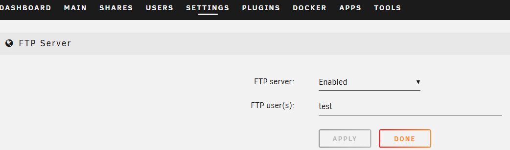

The same user has to be in the Settings -> FTP Server -> FTP user(s)
The share will now look like this, and you will have access to upload and download.
