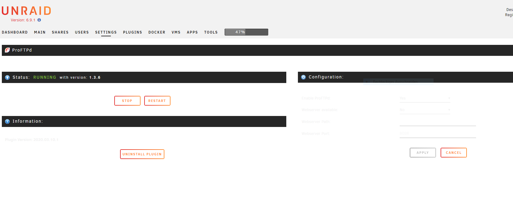

Hey,
if you activate the dark mode in unraid, it is impossible to read the configuration. Could this be fixed in the next update? 🙂
@Autchirion
A future update probably will. It will not be the next one however. That will bring the current proftpd version and fix some underlying ownership and permission problems (not noticeable to the user). Sadly my time to work on this plugin is extremely limited. 😢
The only workaround at the moment is to switch to light mode, change the settings and return to dark mode. I know this sucks, but as it is not often necessary to change the config of the plugin it's not a critical problem.

On 3/26/2021 at 6:48 AM, Autchirion said:
Hey,
Just highlight the text you are having difficulty reading
Or you can "ctrl + A"  and all the text is highlighted and readable
thank you for your responses, I got my workaround, I only wanted to suggest to fix this! 🙂

I updated proFTPd on March 29, it does not start after unraid reboot.
I was having issues getting ProFTP running again after upgrading Unraid to version 6.9.1 using ProFTP 1.3.7a. ProFTP just would not start and I could not get anything in the log. I tried enabling debug logging, but still nothing. I removed the plugin and did a clean install multiple times and still nothing. Then I stumbled upon running this command in terminal
sudo -u root /usr/local/SlrG-Common/usr/local/sbin/proftpd -c /etc/proftpd.conf
which resulted in this error:
2021-03-30 20:12:19,459 TOWER proftpd[24730]: fatal: unknown configuration directive 'IdentLookups' on line 24 of '/etc/proftpd.conf'
So looking at the config file I removed this section at lines 22-24:
# Speedup Login
UseReverseDNS           off
IdentLookups            off
Tehn ProFTP started without any issues.
# Speedup Login
UseReverseDNS           off
IdentLookups            off
THANK YOU VERY MUCH....IT WORKS

I have already added my user account in unRAID and gave the "ftpuser" description. My username is not in the ftpusers file.
Any ideas to get this working?
Here's my proftpd.conf file:
 GNU nano 5.3                                            proftpd.conf                                            Modified
ServerType              standalone

@offroadguy56
By the look of your log I doubt you are connecting to the proftpd service. The errors are thrown by unraids sshd service, so I guess you are trying to connect using SFTP which is an entirely different beast using SSH to connect to your server and then using the SFTP protocol to transfer data. (Even called SFTP it is not the same protocol as FTP.)
If you want to use this, you have to:
  • remove the ftpuser comment from your user (With this comment given, the user is blocked from logging in and getting a normal shell and will only be allowed to use ftp - this is a security precaution by the plugin.)
  • restart the proftpd service so the user is removed from the jail
  • make sure, you can login with this user using ssh, and get a normal shell
  • setup your ftp client to connect using SFTP
Now it should work in theory.
Using this connection type you don't need the proftpd plugin and can remove it.
