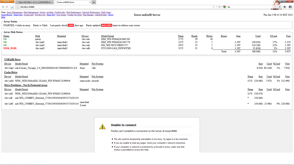

I'm encountering a weird connection issue with UnMenu
If I have my server connected to a wireless bridge, I can only see the top half of the main page, all other pages fail, though the original UnRAID pages work
But if I plug the server into a router or switch, UnMenu works just no internet access.
What would the difference be, between connected by a Wireless Bridge, or a switch
by the bottom part I assume you mean the part that shows the syslog.  If that is the case then the wireless bridge is doing something to the hostname resolution that is causing it to fail most likely.
A picture might help in this case.
Yeah the syslog and all menu and pages that come with UnMenu
So an update, I tripled check the naming of the Unraid server and the router, there was no issue, I can ping any site on the internet using the command line on the server, but then when I try to sue UnMenu, same thing none of the pages work, except half of the main page.

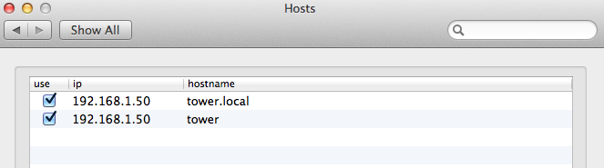

Both PCs and MACs have a file called 'hosts' that maps names to IP addresses.
Its 'hidden' in that users aren't encouraged to play with it.
On my Mac I have THIS installed which adds a Preference Pane allowing easy editing:
http://www.macupdate.com/app/mac/40003/hosts
and here's a snapshot of what my Hosts file looks like (using the Pref Pane interface):
The Hosts file is read FIRST before DNS lookups over the network...
