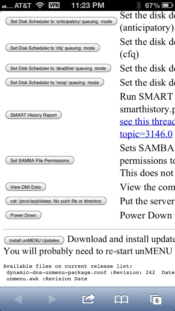

Using the check for updates, then install updates and then restart unmenu is not working to upgrade me from 1.5 to 1.6. At the bottom of the page where it lists the available updates it looks like it can't tell what revision of the unmenu.awk is. See the attached picture.
I'm having the same issue.  Updated from v1.5 to v1.6 and it looks no different.  The additional buttons for classic, vertical and horizontal are there under user scripts, but they don't do anything.  If I click check for updates again I also get this:
Try now.
Working for me now. Looks great. Thanks.
Working now, thanks Joe.

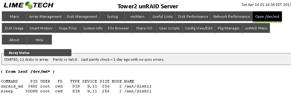

Absolutely.  I've used unMENU since day 1 on my server (about 6 months) and love it.  It certaily looks a lot more modern now.
One thing I noticed, when I used to click open files under system info, it would only list files that were currently streaming or being otherwise read/written by a client.  It seems now that it lists every open file on the box, mainly system files, pages of them.  Did something change or was my previous version not functioning how it was supposed to?
I changed it to make it more useful when people are trying to figure out why their server will not stop.  It will now list all open files.
Ok, at least I'm not crazy.  :D
I used to use it as a quick way to see what was being streamed via Plex, I'll just have to find another way. Thanks for all the hard work!

Download this file, un-zip it and put it (150-unmenu-lsof.cgi) in your unmenu directory.
It will add a tab on the main menu that works like the original command and it will be even more accessible.
It is basically a 4 line shell script (since it also looks in /mnt/cache, otherwise it would be 2 lines)
The "comments" at the top define the "tab label" and "url"
Have fun.  (unMENU was designed to be easily extended.)
Joe L.
150-unmenu-lsof.zip
