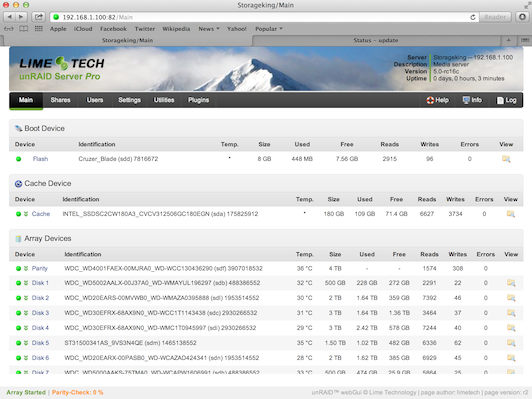

Could someone post screenshots of this? Sounds good!

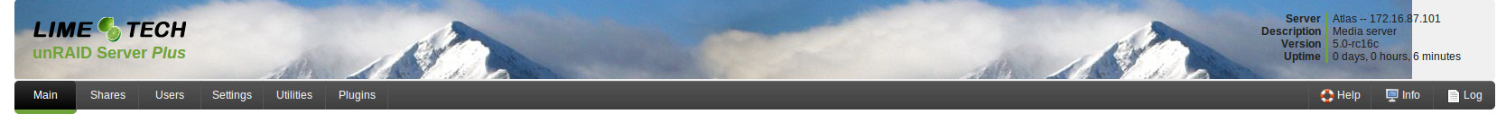

Just spotted the banner at the top doesn't quite fill the width of my screen, see screenshot attached.

2) unRAID Mountain range logo doesn't stretch all the way on my widescreen monitor
