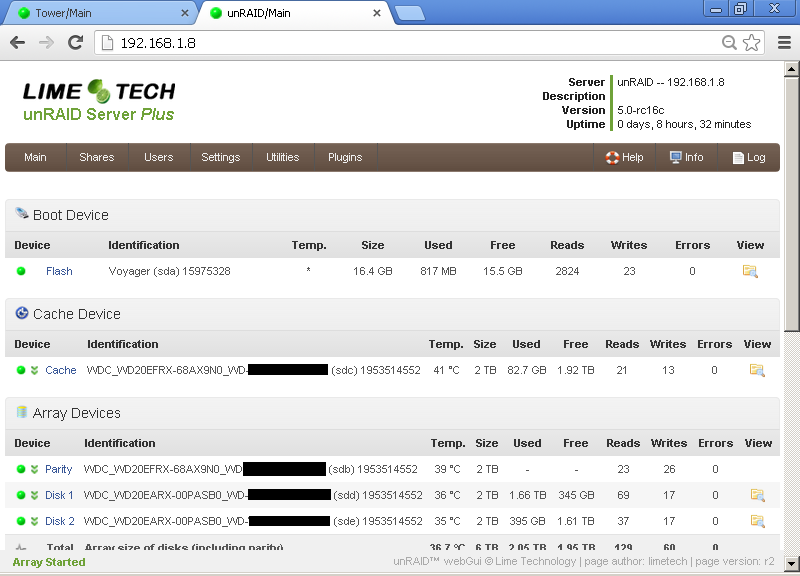

some quick notes, thought vomit.
the zebra striping on the tables should be reversed, aka dont start with white. why? because the boot device table is only going to have one item.. thus it looks odd the table break being the same white..thus it appears to just be floating vs part of the table. the array devices table have a darker footer.. so a white ending row there works fine.
you put a border color for the table header/footer..but not the actual rows.. -- just putting a border on the left/right side (then the last item has bottom as well) would 'complete' the look..
the spinup/down icon seems a bit close to the drive label.. could see accidental clicks happening.. why can i spin down disk thats not installed? (could also desaturate the icon to give it a disabled look)
main page, changed the image type to 'dimmed' and notice the missing image, 'http://husky/plugins/webGui/images/green-blink0.gif' for all my drives -- also the popup for the drive ball colors needs some more.. fontsize/image bg transparency color/etc
when clicking on 'log' on the menu, the font size used for that page seems un-necessalry tiny... the syslog page looks good.
table content starts on the same left margin as the page header and menu.. but have a margin on the right side for the scroll bar.. this makes it look a little odd.. looks like this one is going to be addressed in r3 already
in your setting page, hard resizing your 48x48 images down to 16x16 looks a bit rough, maybe 24x24 will look better (since its size/2).. however really you are better off making a proper resized image rather than relying on the browser to do the scaling for you.. but I understand that means more images/larger plugin.
now that the ui has jquery.. you really should add tablesorter to the tables so users can sort the content easily. (i see you use the old legacy/defunct one on the plugins page) you really really need to check out Mottie's fork which has been actively developed and has much nicer features..
*plugs* https://github.com/Mottie/tablesorter - demo/docs: http://mottie.github.io/tablesorter/docs/index.html
plugin page, the image src for the plugins link to the wiki.. with a link to the wiki image... i would think it should link to the app's homepage? seems like a lot of unneeded traffic to the wiki to get images.. should this not be part of the plugin install so they can be local?
plugins page, author column seems a bit tiny for some of these.. plus it doesn't add to much benefit on being able to sort off this.. maybe move this into the plugin description? that way you can give more room to the 'type' column.
maybe use child rows, example of what you could do (notice you can search within it too) -- http://mottie.github.io/tablesorter/docs/example-child-rows-filtered.html
plugin page, could really use zebra striping here..
plugin page, are all these plugins safe for unraid 4.x? 5.x? some food for thought on handing packages and scenarios to be mindful of: these posts are about unmenu's package installer but would also work here as well: http://lime-technology.com/forum/index.php?topic=27051.msg256168#msg256168 / http://lime-technology.com/forum/index.php?topic=27051.msg256173#msg256173

wonder if it would be best to just put the boot + cache in the the same table with the array.. just segment them in that one table. vs having 3 separate tables with wasted table headers+spacing.. would reduce quite a bit of vertical space.
In part I understand you zoggy, but I would not go that far asking that, if header and bottom status is not always there, sticky, you just scroll a bit and you should have a lot of space to show whatever you want, like all hdd's (or almost in case of really many) even on small on screens... I think.
Btw, one last suggestion, I was to ask that before but didn't wanted to be annoying for something that will probably not be useful for all... but now seeing that a lot of display options got added... would it be possible to add one more option to allow showing temperature for spindown disks? I know that many hdd's will wake with that... but some doesn't, I'm sure that at least wd red ones doesn't as sometimes I manually pool them manually with smartctl.
I suspect cache is separate because soon there will be the ability to have a cache pool which means there will potentially be multiple drives in that section, possibly with the option to configure them in a variety of ways...

non array disks kinda just get tossed in at the bottom and doesn't look that great.  This SS shows my unraid .vmdk disk chilling a bit out of place:
Haha, yup that needs some work.
