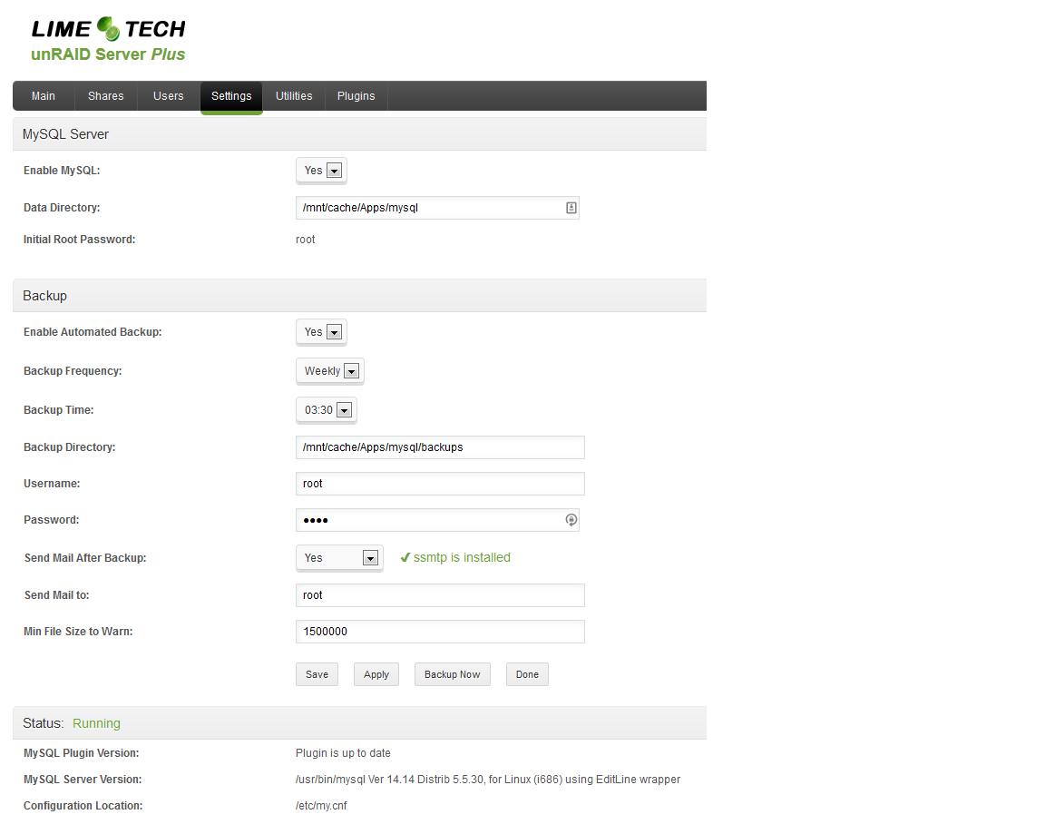

I got this plugin setup and running fine, got my OpenELEC machines configured and the database is working great. However I am running into an error when doing backups of the MySQL database. I have ssmtp setup and working via unmenu, I have MySQL setup to do weekly backups and sent email to root. Below are the errors I am getting in the email:
#1 - MySQL backup error: "File not found or corrupt!" mysqlbackup_2014_01_06-03_30.sql.gz
#2 --Warning: Skipping the data of table MySQL.event. Specify the --events option explicitly.
When I go to my backup location the backups are present.
I am running unRAID 5.0.4 and installed MySQL thru control panel.
Attached is a screen shot of the MySQL config page, any information on this would be great.
Thanks
Your backup file is smaller than the min file size (defined in config page/webgui). If you are sure that your backup is OK you can lower your min file size to match your backup size. Second error is not really an error just a warning we don't/can't backup event tables while mysql is running. And I guess we don't need them.

I adjusted the min file size and am now getting the success email after backup, I'm certain the backup is OK as I'm still building my media library so its not very big at the moment. Thanks for the info and your work on this plugin.
