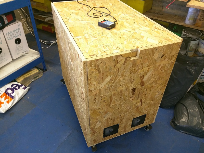

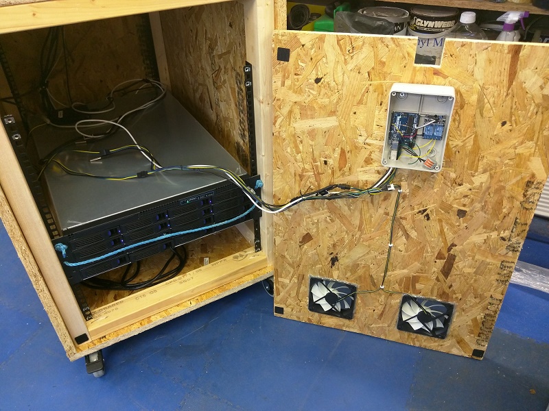

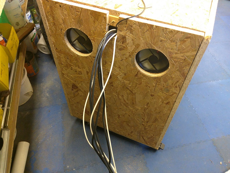

Seeing as some of you asked here is my GarageRack! Air flow is in at the lower front through the mesh filters on the fan and out at the top rear. Arduino controls the PWM for the rack fans, but takes the power from a fan connector on the motherboard. Arduino also cuts the power to the rack fans below 17 deg C.
The CPU and drive fans inside the server case are all triggered from the Drive temperature using the IPMI plugin.
Ambient temp in the garage is about 12 deg C. Temp inside the cab is 18 deg C. Drive temps are set to centre around 30 deg C. We'll see how it goes as the outside temp drops.
There is a UPS underneath the server.
I'll tidy the cabling and edges up once I'm happy this all works properly. Test server will also go in this rack.
FRONT
BACK
INSIDE
