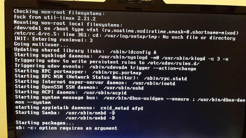

I don't think the go script is kicking off. At least unmenu & cache_dirs didn't start. The login prompt never displays on the PC but everything else seems to be functioning fine. My plugin folders are empty.
Please don't run any add-ons or plugins with this release, except updated webGui as it becomes available.
Whoops - those had been in the go script for so long that I thought the "Starting plugin" part was from day 1. Commented out everything not in the original go script and got the login prompt.
unmenu is working here... So go script is started...
Also I have some special commands in my go script to fill crontab, those have run, so go script is working..
