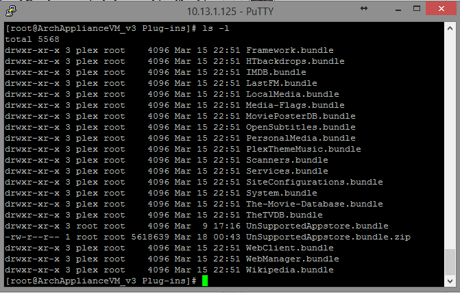

Set the permissions
What would the permissions need to be?

Same as all the other plugin folders. I don't remember off the top of my head and currently on mobile. Make sure the plex user has read and write access to it

Make sure to restart Plex too otherwise it will never show
So it appears the permissions are the same as all the other files.  ANy ideas?
I've even rebooted the VM

Mahdi-Rom
Permissions are not the same, not for plex user. The appstore folder is owned by root, and group and others do not have write access (ie. plex user cannot write). Either change owner to plex, or give that folder write permissions for group and others as well
